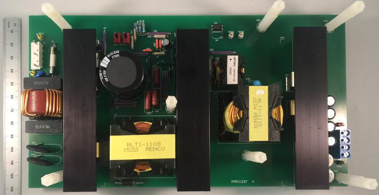

UCC29950应用资料LLC+PFC组合控制器的电源方案
PMP11237 is a complete AC/DC power supply reference design with universal AC input and 12V/25A output. LLC+PFC combo IC UCC29950 is applied as the main controller with high voltage bridge gate driver UCC27714 applied as the driver of the LLC input MOSFETs.  This design evaluates the performance  (...)
  主要特色
  • Universal AC input and 12V/25A output
  • 5" x 9.2" board dimension
  • Single layer board design
  • Conduction EMI tested
  • PFC + LLC using combo IC UCC29950
