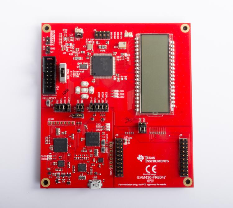

超声波感应水表前端参考设计包括BOM及原理图
            This reference design helps designers develop an ultrasonic water-metering subsystem using an integrated, ultrasonic sensing solution (USS) module, which provides superior metrology performance with low-power consumption and maximum integration. The design is based on the 256KB MSP430FR6047  (...)
主要特色
  • Best-in-class metrology performance: 25-ps zero-flow drift (ZFD) and 32-ps single-shot standard deviation
  • Low-power consumption: Approximately 2.5 μA with 1-MHz transducer at 1 measurement per second for metrology
  • Flexibility to test different pipes and transducers; direct interface to pair of  (...)
