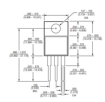

你好,
我正在寻找这部分散热垫的尺寸。
LT1084CT-5#PBF-ND
它能够达到5A,但我们很可能不会使用3A电流消耗。
感谢您的帮助!

        Hello,
I am looking for the dimension of the thermal pad for this part.
LT1084CT-5#PBF-ND
It is capable of 5A but most likely we won’t be using it about 3A current draw.
Appreciate your help! Thank you

以下是零件本身的尺寸。
看着你想要大约10x15来覆盖背垫。
我们还为TO-220部件预先切割了一些焊盘,但是您需要验证散热规格是否符合您的应用要求。

        Hello @vatsal.naik
Here are the dimensions of the part itself.
Looking at that you would want to be around 10x15 to cover the back pad.
We also have some pads that are pre-cut for the TO-220 parts, however you would need to verify the thermal specs will meet your application.
Thank  you
