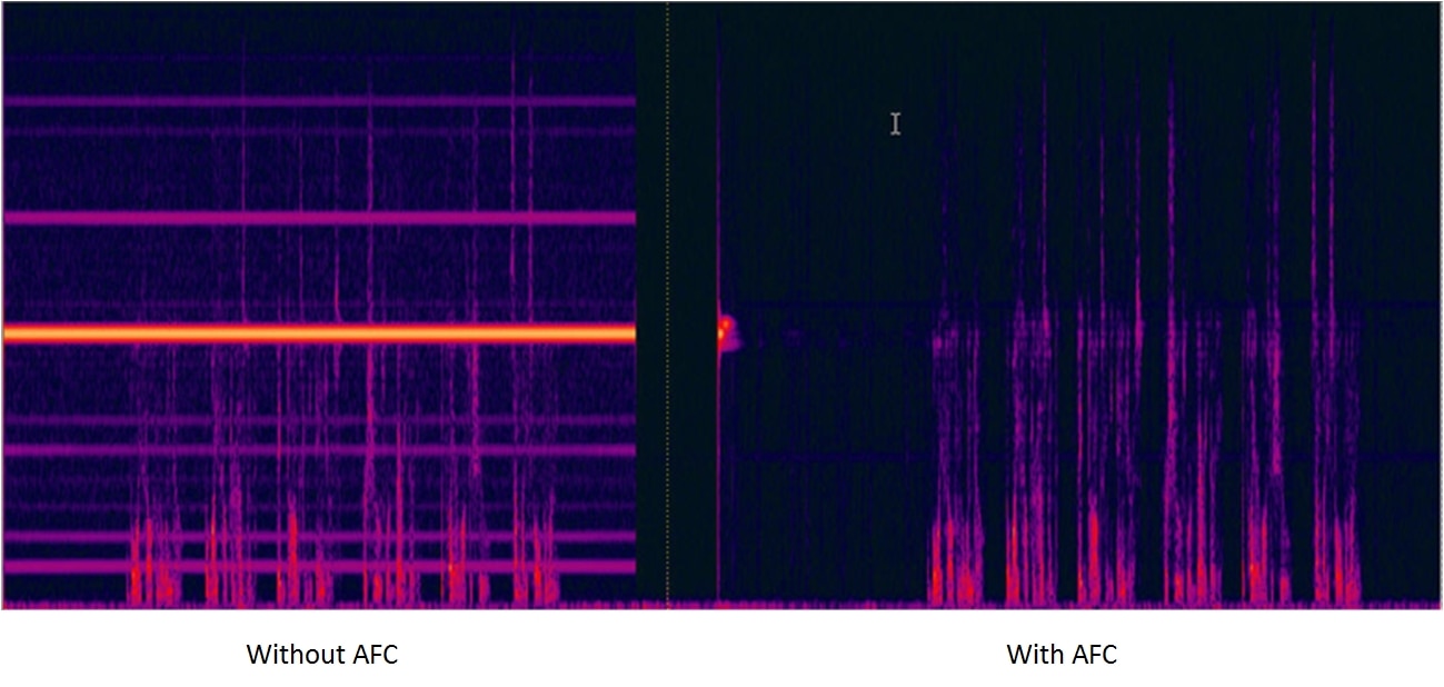

现在,自适应反馈消除(AFC)已成为数字助听器中无处不在的特性。
AFC通过从麦克风信号中减去助听器反馈信号的估计来操作。
如果反馈估计与麦克风拾取的实际反馈相匹配,则消除反馈。
这种反馈抑制方法优于其他方法,因为与没有AFC的情况相比,它实际上消除了反馈并允许增益增加。

Now, Adaptive Feedback Cancellation (AFC) has become a ubiquitous feature in digital hearing aids. AFC operates by subtracting an estimate of the hearing-aid feedback signal from the microphone signal. If the feedback estimate matches the actual feedback picked up by the microphone, the feedback is eliminated. This approach to feedback suppression is preferred over other methods because it actually eliminates feedback and permits an increase in gain compared to that possible without AFC.
