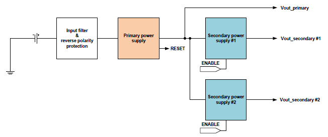

故事通常是由汽车自有设备制造商(OEM)设定的整体系统Iq目标开始,然后将其划分为关键系统块;
通常,剩余部分是电源需要遵守的。
次级负载点(POL)稳压器通常可以禁用,每个功耗仅为1μA。
然而,来自电池的主电源通常是静态电流的主要消耗者。
图1  - 典型的汽车系统电源框图

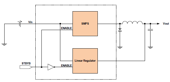

在负载电流高或需要最小化功耗的情况下,需要考虑开关模式电源(SMPS)。
正如我之前的博客中所讨论的,实现这一目标的一种方法是使用脉冲频率调制(PFM)或突发模式等技术,但另一种方法可能是使用集成混合拓扑,其中线性稳压器和SMPS是
并行使用。
当系统处于唤醒状态时,SMPS被启用且线性稳压器被禁用,当系统处于静止状态时,SMPS被禁用并启用线性稳压器。
线性稳压器吸收低Iq。
这种方法可以提供低至25μA(典型值)的Iq。
开关功能(SMPS和线性模式之间)可通过监控负载电流实现自动化,例如使用安森美半导体NCV891330低Iq双模式降压稳压器,或手动系统控制开关,例如
NCV97310多输出电源管理单元。
两种情况下的输出电容都可以在模式之间提供平滑切换,而不会出现毛刺。
然而,这种方法的一个限制是输入电压顺应性。
图2  - 混合线性/ SMPS转换器

To be low Iq or not to be low Iq, that is the question…  Doubtful use of Shakespeare, twisted to title an engineering topic, aside, quiescent current (Iq) is a big question for many automotive systems.  How low is low?  How does one achieve it?  And what are the trade-offs?  Very often the story starts with an overall system Iq target set by the automotive Own Equipment Manufacturer (OEM), which is then divided amongst the key system blocks; generally the remainder is what the power supply is required to comply with.  The secondary, point-of-load (POL), regulators can often be disabled to consume as little as 1 µA each.   However, the primary power supply, which sources from the battery, is often a major consumer of quiescent current.
Fig. 1 – Typical Automotive System Power Supply Block Diagram
Where the load current is high or power dissipation needs to be minimised then a switched mode power supply (SMPS) needs to be considered.  As discussed in my previous blog, one way of achieving this is by use of techniques such as pulse frequency modulation (PFM) or burst-mode, but another means might be the use of an integrated hybrid topology where a linear regulator and an SMPS are used in parallel.
When the system is awake then the SMPS is enabled and the linear regulator disabled, and when the system is in its quiescent state then the SMPS is disabled and the linear regulator enabled.  The linear regulator draws a low Iq.  Such an approach can deliver an Iq as low as 25 µA (typ).  The switching function (between SMPS and linear modes) can be automated by monitoring the load current, such as with the ON Semiconductor NCV891330 low-Iq dual-mode step-down regulator, or manual where the system controls the switching, such as with the NCV97310 multi-output power management unit.  The output capacitance in both cases is relied upon to deliver smooth switching between modes, without glitches.  One limitation of such approaches though is input voltage compliance.
Fig. 2 – Hybrid Linear/SMPS Converter
