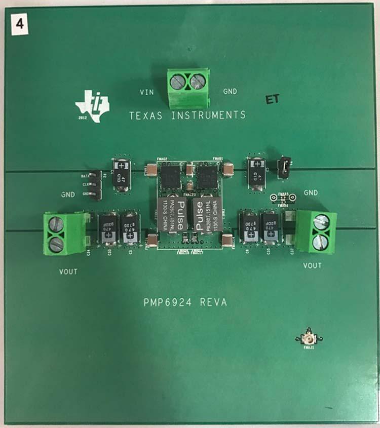

紧凑型单路60A POL解决方案包括BOM及PCB布局
            The PMP6924 reference design is a compact single 60A POL solution with PMBus in 0.7" by 0.95" size (17.8mm x24.1mm). It showcases NexFET power block CSD87350Q5D in high density PoL. It also has excellent thermal performance. It is suitable for PMBus-equipped high current applications with size  (...)
主要特色
  • 8V to 14Vin, 1V/60A out
  • Peak efficiency 91% at 1Vout, 300kHz
  • Excellent thermal performance; 50 degree temperature rise with 200LFM
  • Total solution size:  0.7" x 0.95" (17.8mm x 24.1mm)
  • PMBus enabled margining and sequencing
