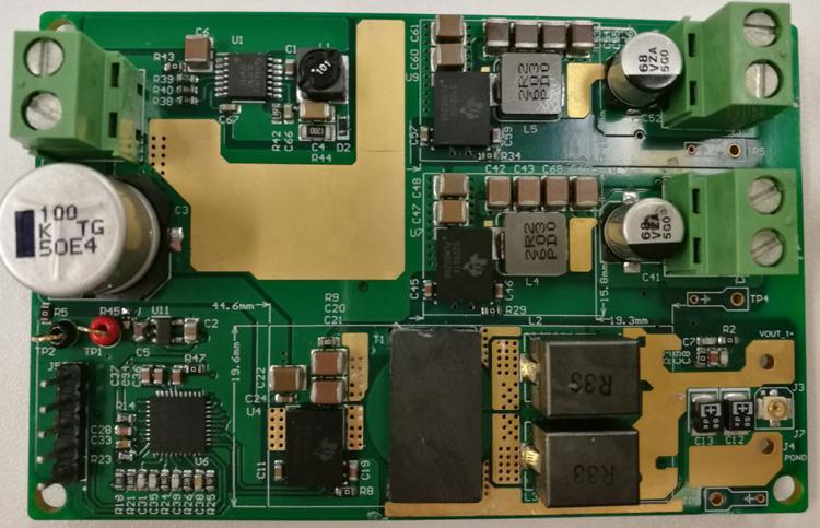

具有3路输出基于GaN的数字POL参考设计包括BOM及层图
            The PMP4486 is a GaN-based reference design solution for telecom and computing applications. The GaN module LMG5200 enables a high efficiency single stage conversion with an input range from 36 to 60V down to 29V, 12V and 1.0V. This design shows the benefits of a GaN based design with high  (...)
主要特色
  • Extra high efficiency up to 98.4%
  • High operating frequency for small size
  • Ease of design using LMG5200 GaN FET module
  • Full digital control with UCD3138A enable flexible design
  • S.R buck topology and half-bridge current-doubler
