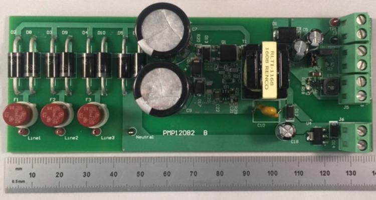

三相输入和三路输出的偏置电源参考设计包括BOM及框图
            The PMP12082 is a bias supply reference design with 3-phase input (80VAC~280VAC) and triple outputs - 7V/1.4A, 3.3V/500mA, and 3.3V/300mA. UCC28701 primary side regulation controller is applied for a Cascode-MOSFET flyback converter with dual output windings. One winding supplies 7V/1.4A output with  (...)
主要特色
  • 80VAC to 280VAC three-phase input, 7V/1.4A, 3.3V/500mA and 3.3V/300mA outputs
  • Allow two line drop - single phase AC input
  • Cascode flyback with primary side regulation controller
  • 2" x 5.4" board dimension
  • Test report available
