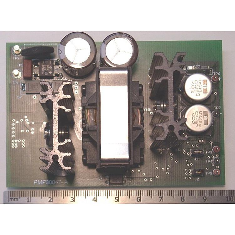

双元件铅酸电池充电器参考设计包括BOM及层图
            A quasi-resonant isolated flyback is employed to charge two lead-acid battery elements, starting from high-line mains. The converter accepts two external signals (referred to secondary side) to provide the reference voltages, which set output voltage and current. The converter shows good wide-range  (...)
主要特色
  • Low cost, low EMI isolated flyback converter thanks to valley switching
  • Compact solution (small footprint: only 60mm x 60mm) supplies 64W maximum with almost flat efficiency (78%...89%) from 0.1A to 2A
  • Employs a depletion-mode startup FET to further reduce standby lossses
