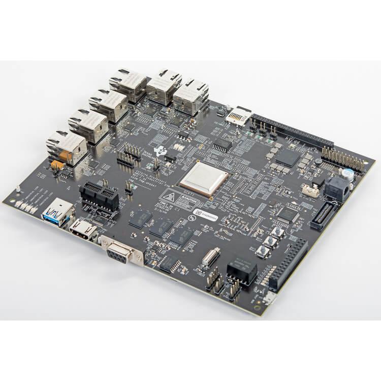

基于IEC61850 GOOSE的数据包处理引擎包括BOM及组装图
The tiDEP0074 reference design demonstrates packet switching and filtering logic implemented in the M4 core of AM572x based upon the Ethertype, MAC address and Application ID (APPID) of GOOSE packets received from the PRU-ICSS. Packets are filtered and routed to destinations in order to allow  (...)
主要特色
  • Ethernet packet switching logic and IEC61850 GOOSE filtering algorithm implemented on ARM Cortex-M4 cores of AM572x to determine destination routing to A15 or further processing in M4.
  • Interprocessor Communication (IPC) using messageQ in A15 with Linux, and in M4 and DSP with TI-RTOS
  • PRU-ICSS firmware  (...)
