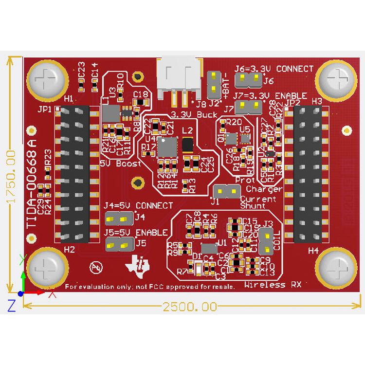

具有19mm线圈的Booster Pack完整电池管理解决方案包括BOM及原理图
The tiDA-00881 reference design is a booster pack that provides a wireless charger and an entire battery managment solution to power any low power TI Launchpad. This design is a  highly integrated power management solution that is well-suited for ultra-low power applications using an off the  (...)
主要特色
  • Off the shelf wireless receiver coil
  • Coin cell storage to 50mA
  • 31uA quiescent current
  • 3.3Vdc buck from the TPS62736 to power the Launchpad
  • 5V boost to power support circuitry
  • Stackable design allows for creating a complete solution
