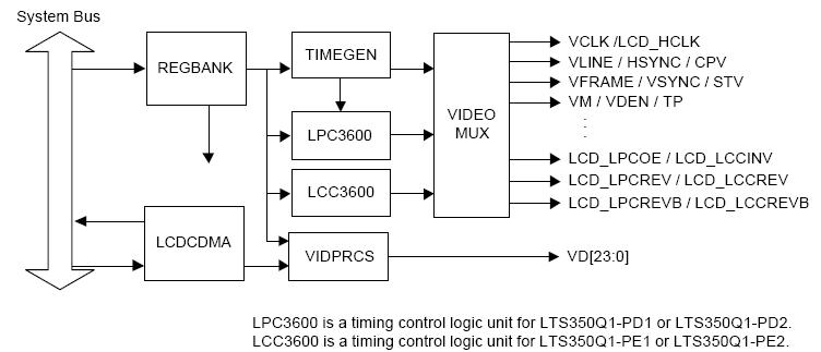

2440的LCD 驱动控制器如下:
要想正确使用LCD,必须注意两点:1、时序;2、显示缓存区。

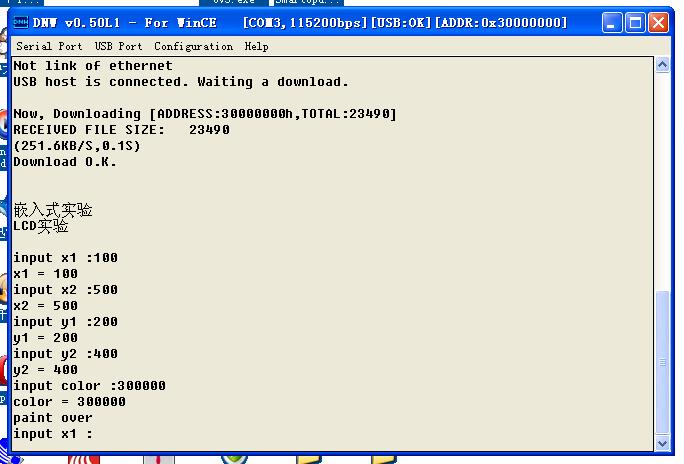

下面是实验程序:

Uart_Printf("LCD实验nn");
lcd_init();
while(1)
   Uart_Printf("input x1 :");
   x1=Uart_GetIntNum();
   Uart_Printf("x1 = %dn",x1);
   Uart_Printf("input x2 :");
   x2=Uart_GetIntNum();
   Uart_Printf("x2 = %dn",x2);
   Uart_Printf("input y1 :");
   y1=Uart_GetIntNum();
   Uart_Printf("y1 = %dn",y1);
   Uart_Printf("input y2 :");
   y2=Uart_GetIntNum();
   Uart_Printf("y2 = %dn",y2);
   Uart_Printf("input color :");
   color=Uart_GetIntNum();
   Uart_Printf("color = %dn",color);
   rectangle(x1,x2,y1,y2,color);//画一个矩形
   Uart_Printf("paint overn");

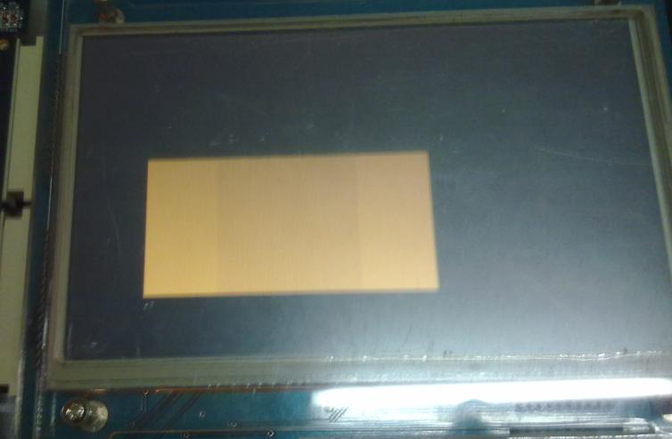

实验结果如下:
