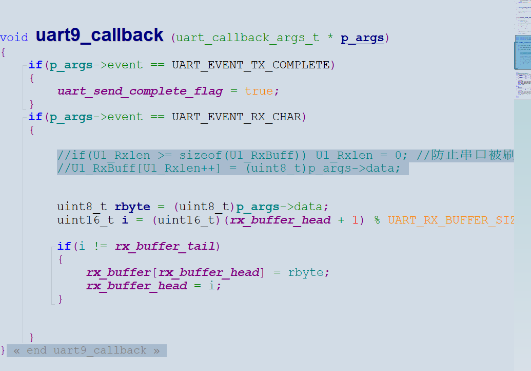

主要是要在串口中断接收函数中进行调用处理
void uart9_callback (uart_callback_args_t * p_args)
if(p_args->event == UART_EVENT_TX_COMPLETE)
uart_send_complete_flag = true;
if(p_args->event == UART_EVENT_RX_CHAR)
uint8_t rbyte = (uint8_t)p_args->data;
uint16_t i = (uint16_t)(rx_buffer_head + 1) % UART_RX_BUFFER_SIZE;
if(i != rx_buffer_tail)
rx_buffer[rx_buffer_head] = rbyte;
rx_buffer_head = i;

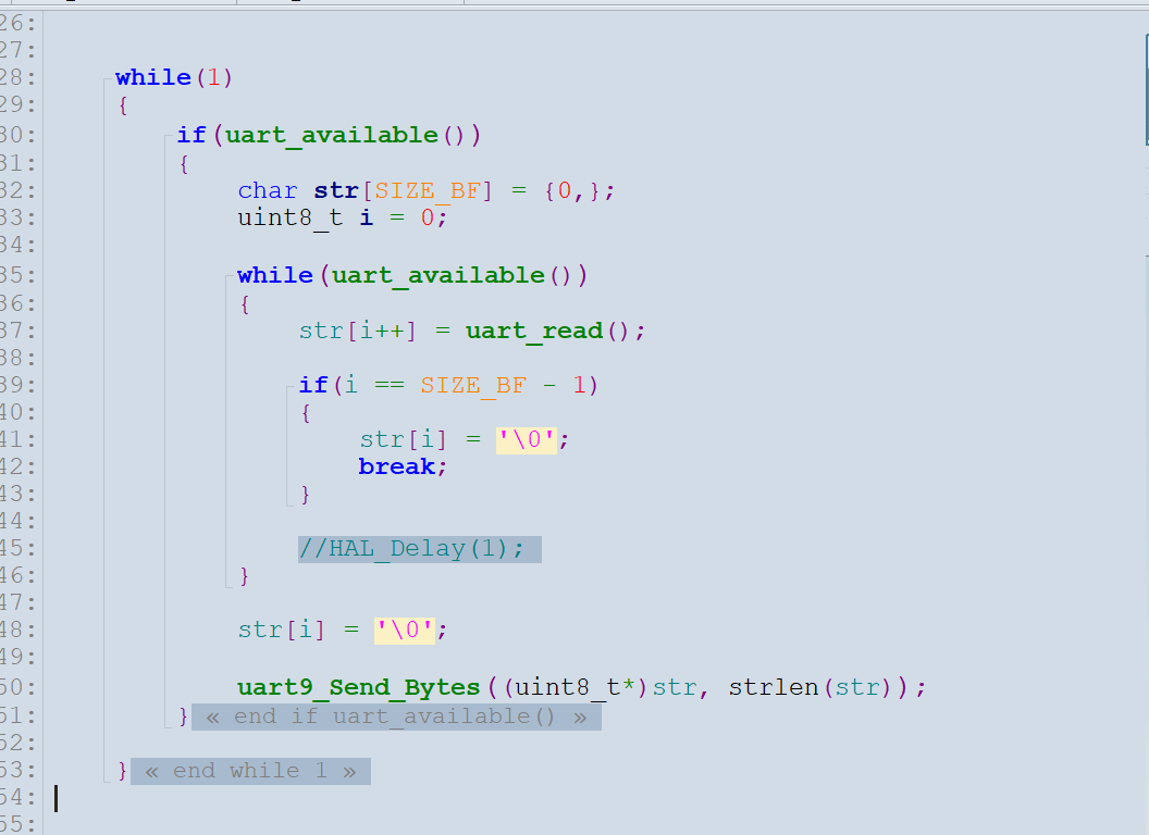

主函数中添加核心代码
将串口接收到的不定长度的数据发送回去

while(1)
if(uart_available())
char str[SIZE_BF] = {0,};
uint8_t i = 0;
while(uart_available())
str[i++] = uart_read();
if(i == SIZE_BF - 1)
str[i] = '\0';
break;
str[i] = '\0';
uart9_Send_Bytes((uint8_t*)str, strlen(str));

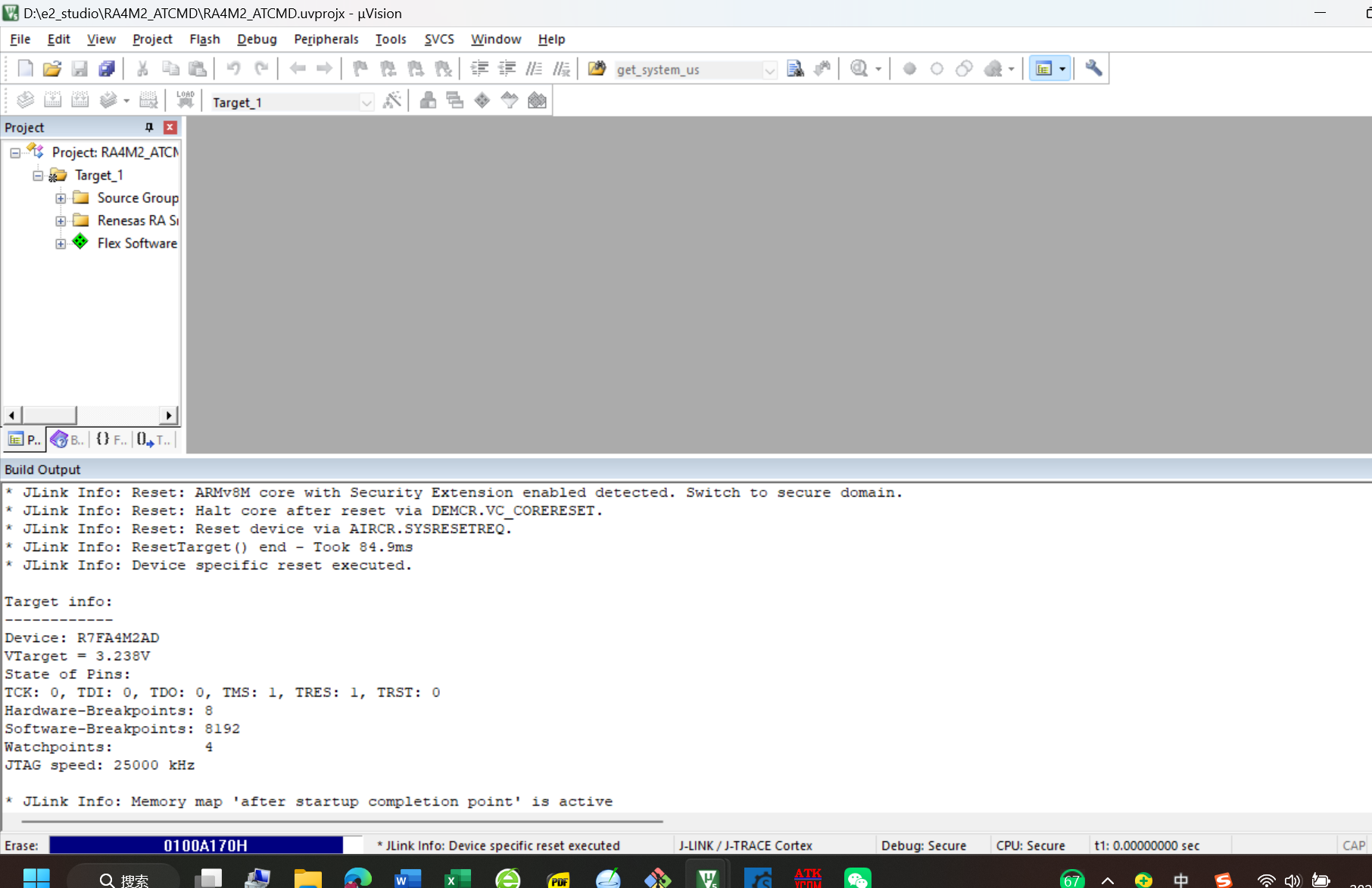

编译代码,烧录到板子

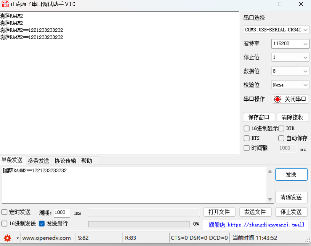

打开串口助手
可以看到发送任何数据,都能完美的发送回去
