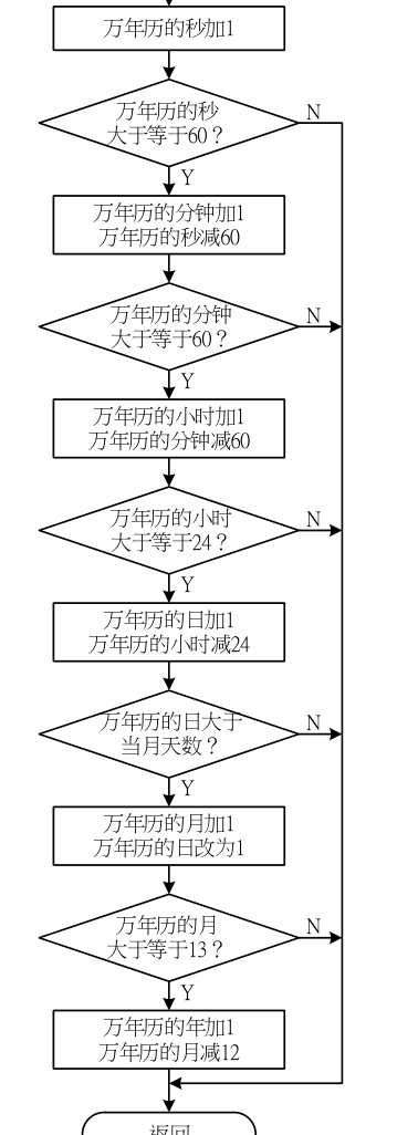

很多人只会使用瑞萨单片机自带的RTC日历,如果让它们用一个普通的定时器来实现RTC的功能,它们永远都实现不了,学不会!已经故步自封了。
本帖就是来给这些人扫盲的,就让我来用最普通的定时器实现软件万年历!!!
我的软件架构设计如下图所示
这里直接使用ARM CM3的systick定时器,所以不需要配置RA smart了,直接用我之前配好的串口工程即可。
直接上核心代码

TimeStamp datetime;
volatile uint32_t Timer_1s_Count;

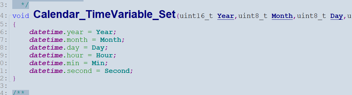

- [url=home.php?mod=space&uid=2666770]@Brief[/url] Set the time variable of the calendar function
- @param[in] Year: This parameter is year.
- @param[in] Month: This parameter is month.
- @param[in] Day: This parameter is day.
- @param[in] Hour: This parameter is hour.
- @param[in] Min: This parameter is min.
- @param[in] Second: This parameter is second.
- @retval Non.
void Calendar_TimeVariable_Set(uint16_t Year,uint8_t Month,uint8_t Day,uint8_t Hour,uint8_t Min,uint8_t Second)
datetime.year = Year;
datetime.month = Month;
datetime.day = Day;
datetime.hour = Hour;
datetime.min = Min;
datetime.second = Second;

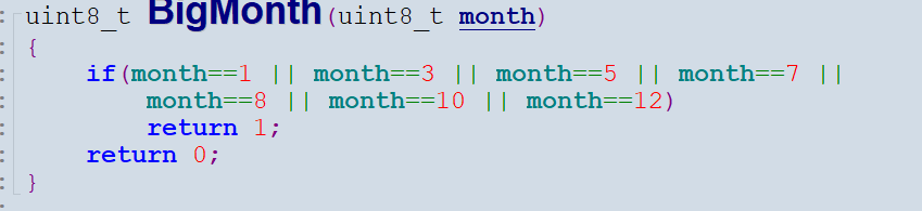

- @brief Judge whether the number of days in the month is 31
- @param[in] month: This parameter is month.
- @retval Yes(1) or No(0).
uint8_t BigMonth(uint8_t month)
if(month==1 || month==3 || month==5 || month==7 ||
month==8 || month==10 || month==12)
return 1;
return 0;

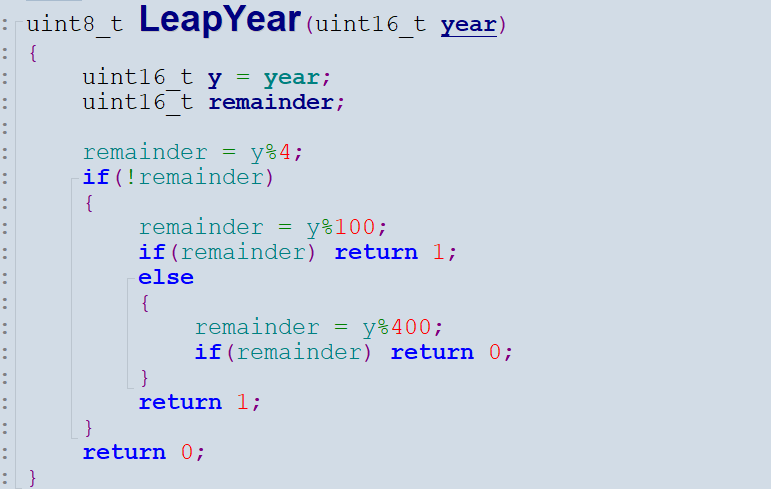

@brief Judge whether the parameter is leap year
@param[in] year: This parameter is year.
uint8_t LeapYear(uint16_t year)
uint16_t y = year;
uint16_t remainder;
remainder = y%4;
if(!remainder)
remainder = y%100;
if(remainder) return 1;
else
remainder = y%400;
if(remainder) return 0;
return 1;
return 0;

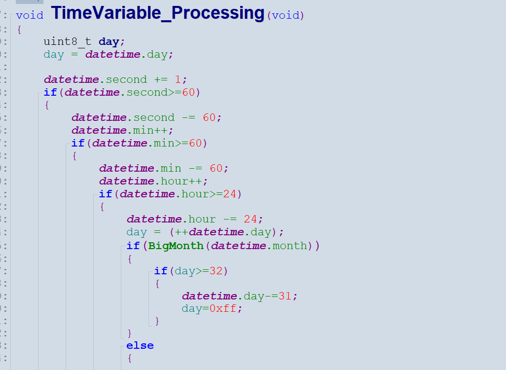

@brief Calendar time variable update.
@param[in] Non.
@retval Non.
void TimeVariable_Processing(void)
uint8_t day;
day = datetime.day;
datetime.second += 1;
if(datetime.second>=60)
datetime.second -= 60;
datetime.min++;
if(datetime.min>=60)
datetime.min -= 60;
datetime.hour++;
if(datetime.hour>=24)
datetime.hour -= 24;

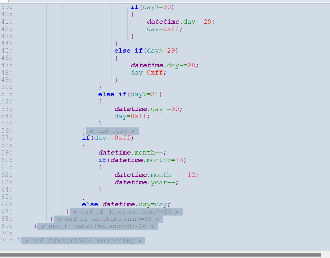

day = (++datetime.day);
if(BigMonth(datetime.month))
if(day>=32)
datetime.day-=31;
day=0xff;
else
if(datetime.month==2)
if(LeapYear(datetime.year))
if(day>=30)
datetime.day-=29;
day=0xff;
else if(day>=29)
datetime.day-=28;
day=0xff;
else if(day>=31)
datetime.day-=30;
day=0xff;
if(day==0xff)
datetime.month++;
if(datetime.month>=13)
datetime.month -= 12;
datetime.year++;
else datetime.day=day;
void SysTick_Handler(void)
g_tick_count++;
g_20ms++;
if(g_20ms == 20)
g_20ms = 0;
TimeVariable_Processing();
判断大小月
判断闰年
年月日时分秒进制
然后再定时器里调用

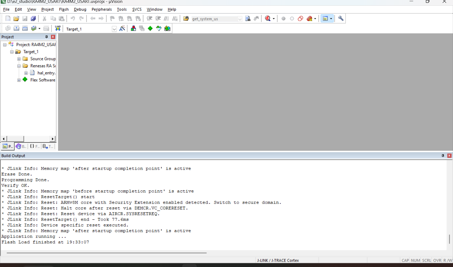

主函数核心代码
#include "hal_data.h"
#include "LED.h"
#include "Systick.h"
#include "usart0.h"
#include "usart9.h"
#include "shell.h"
//#include "ebtn_app.h"
FSP_CPP_HEADER
void R_BSP_WarmStart(bsp_warm_start_event_t event);
FSP_CPP_FOOTER
main() is generated by the RA Configuration editor and is used to generate threads if an RTOS is used. This function
is called by main() when no RTOS is used.

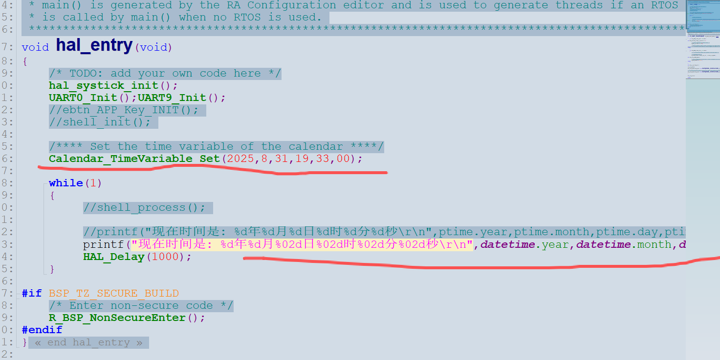

void hal_entry(void)
/ TODO: add your own code here */
hal_systick_init();
UART0_Init();UART9_Init();
//ebtn_APP_Key_INIT();
//shell_init();
/**** Set the time variable of the calendar ****/
Calendar_TimeVariable_Set(2025,8,31,19,33,00);
while(1)
//shell_process();

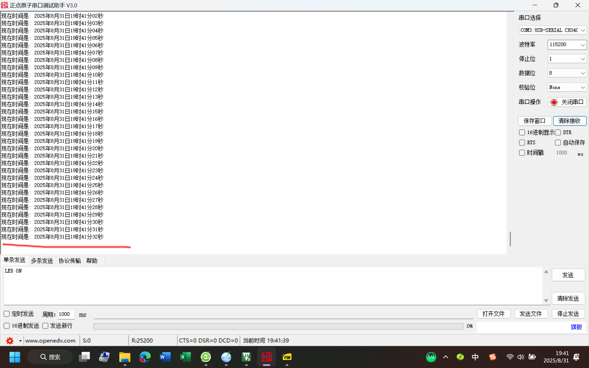

//printf("现在时间是: %d年%d月%d日%d时%d分%d秒\r\n",ptime.year,ptime.month,ptime.day,ptime.hour,ptime.min,ptime.second);
printf("现在时间是: %d年%d月%02d日%02d时%02d分%02d秒\r\n",datetime.year,datetime.month,datetime.day,datetime.hour,datetime.min,datetime.second);
HAL_Delay(1000);

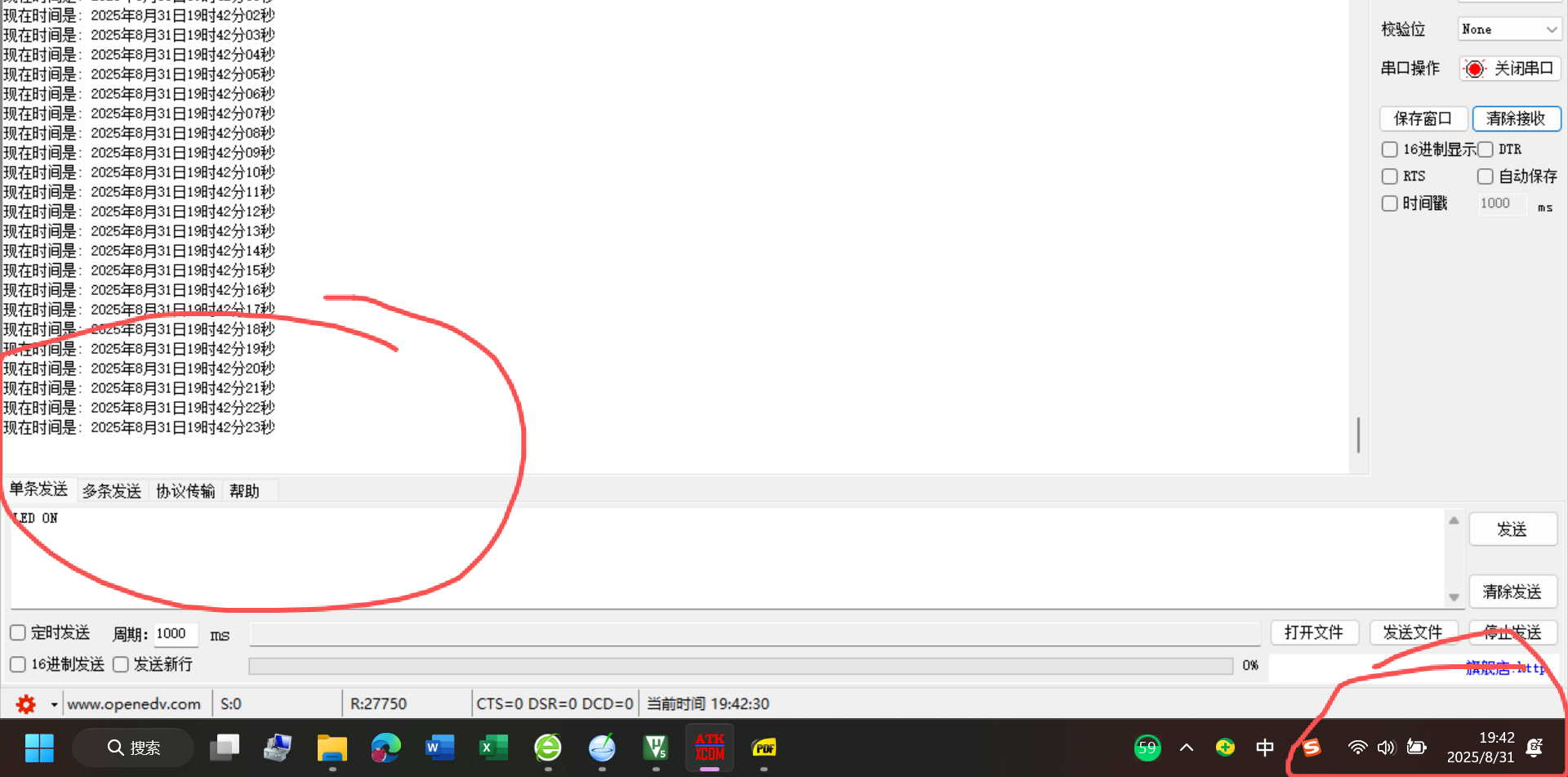

烧录代码
打开串口助手
可以看到和网络时间一致,非常的准确
详情看视频
