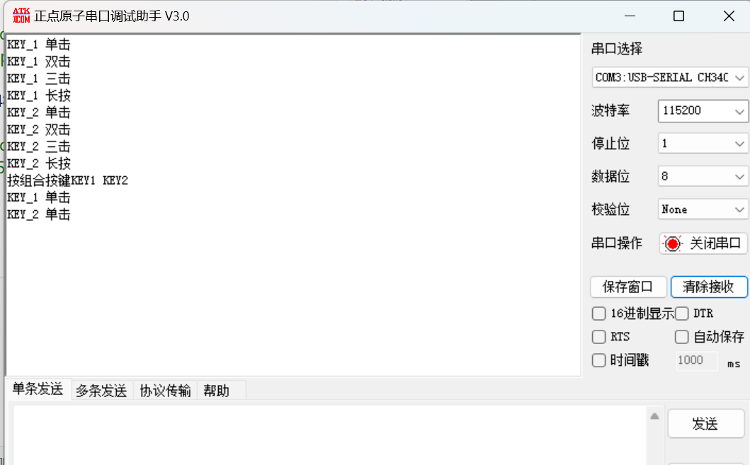

本文就是我个人自创的按键最齐全的算法,实现了按键的所有功能,包括单击,双击,三击,短按,长按,组合按键。你想要的都有!!!!

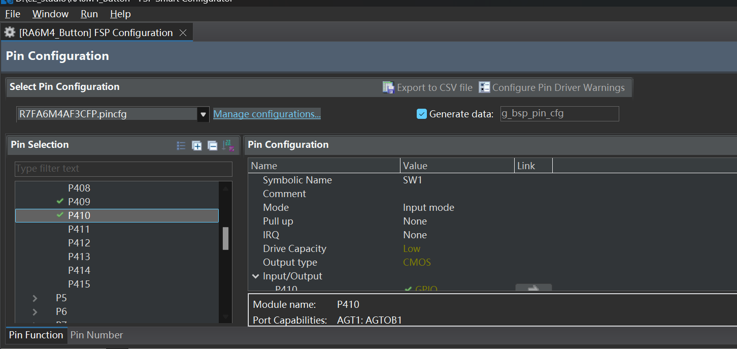

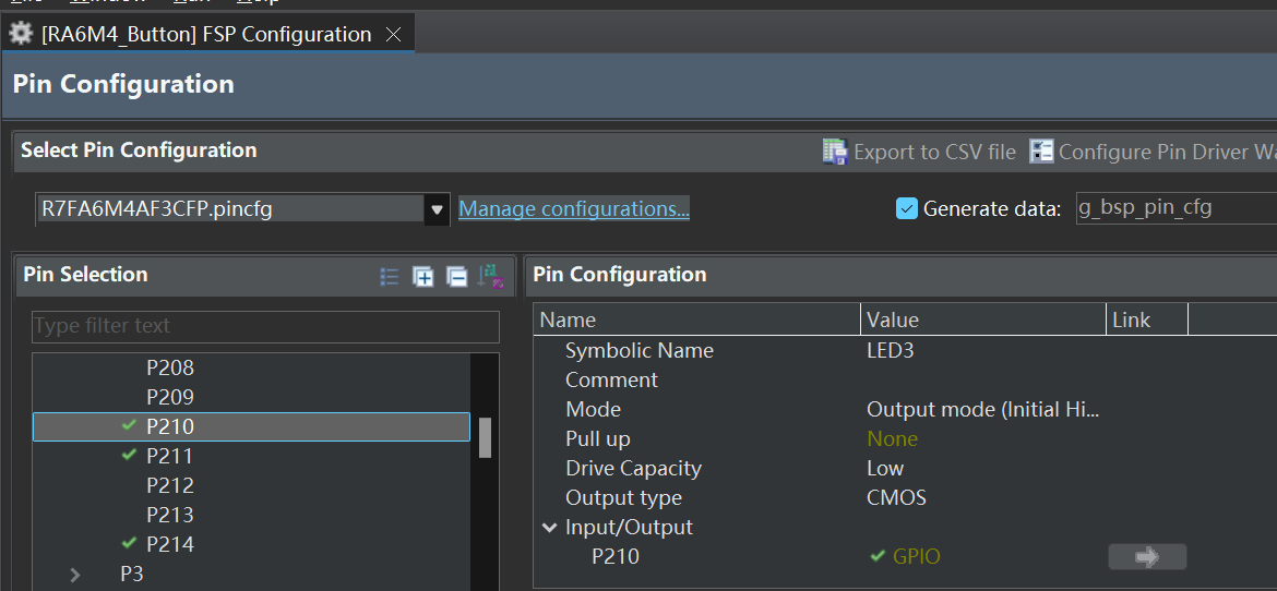

1。打开RA smart 配置工具

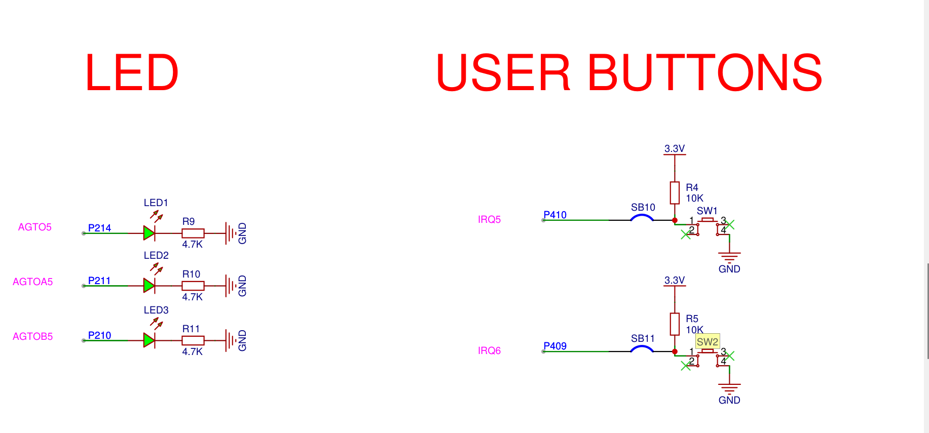

新建工程,打开原理图,配置按键IO口
两个按键分别是P410和P409

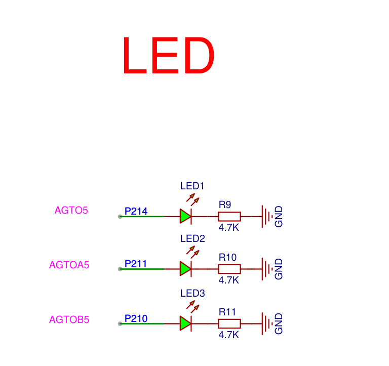

2。配置LED口
3个LED分别是
P214 P211 P210

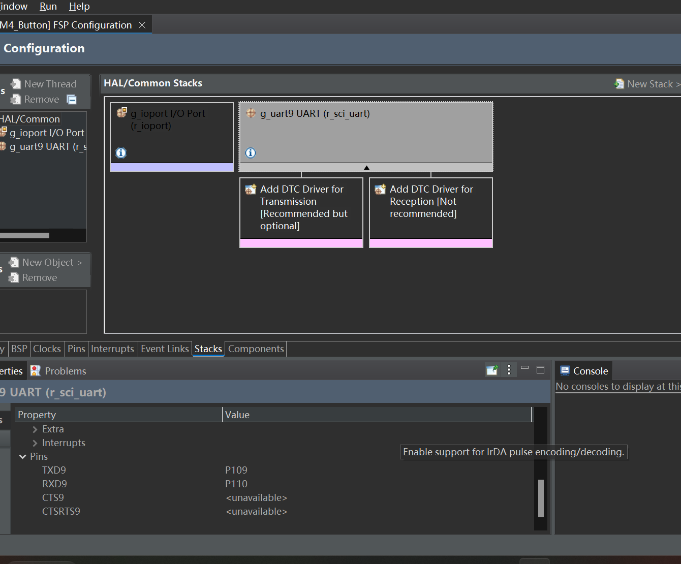

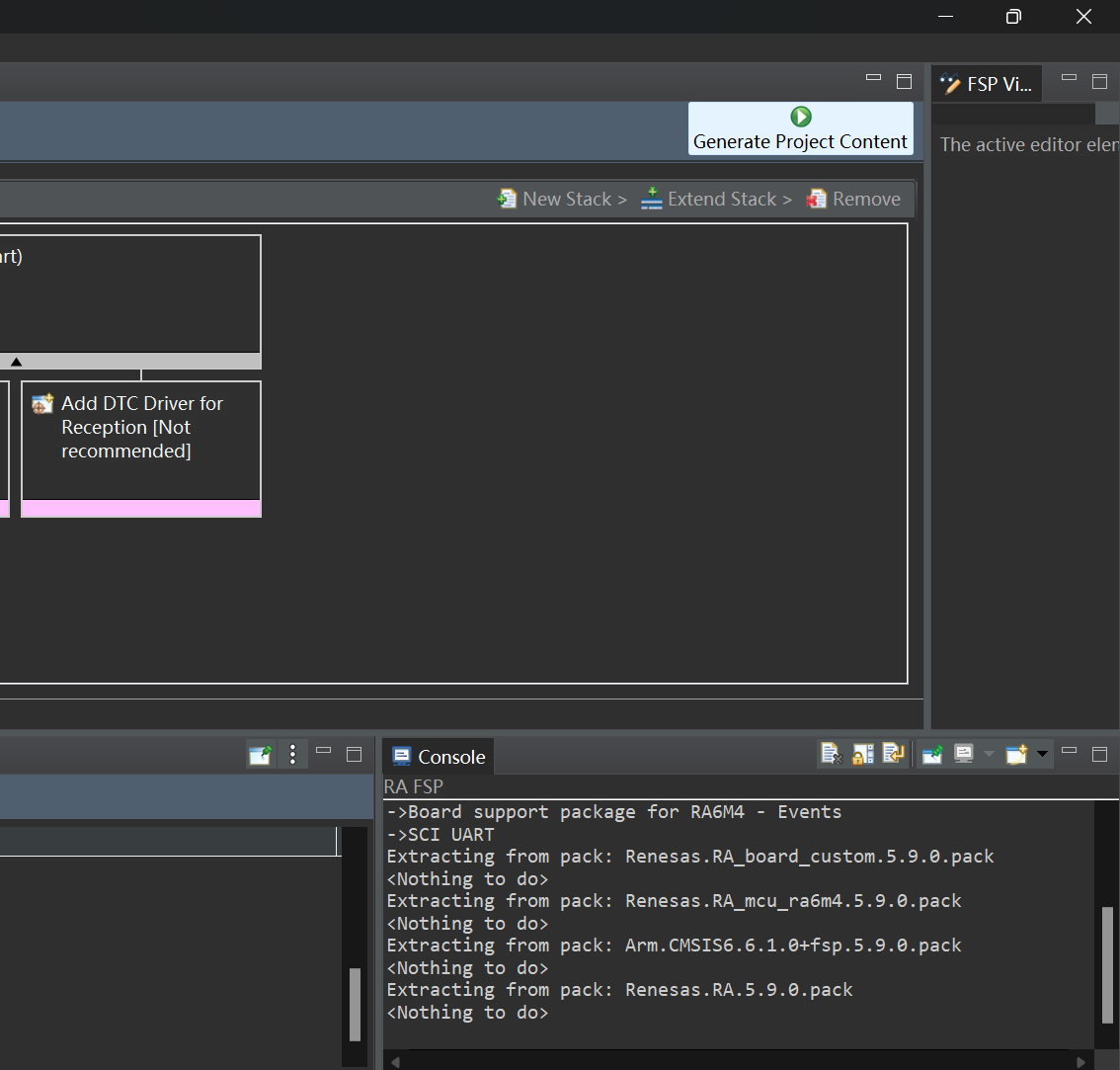

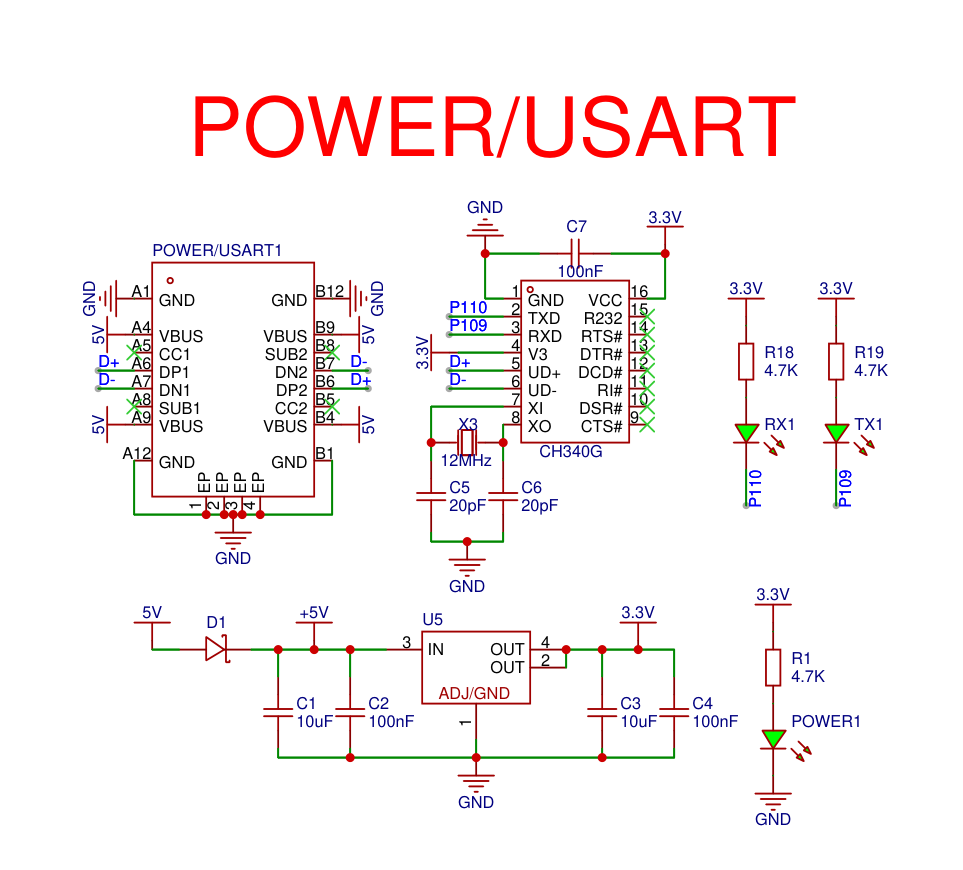

3。配置串口9
串口RX 为 P109
TX为P110
对应串口9
4。生成工程代码

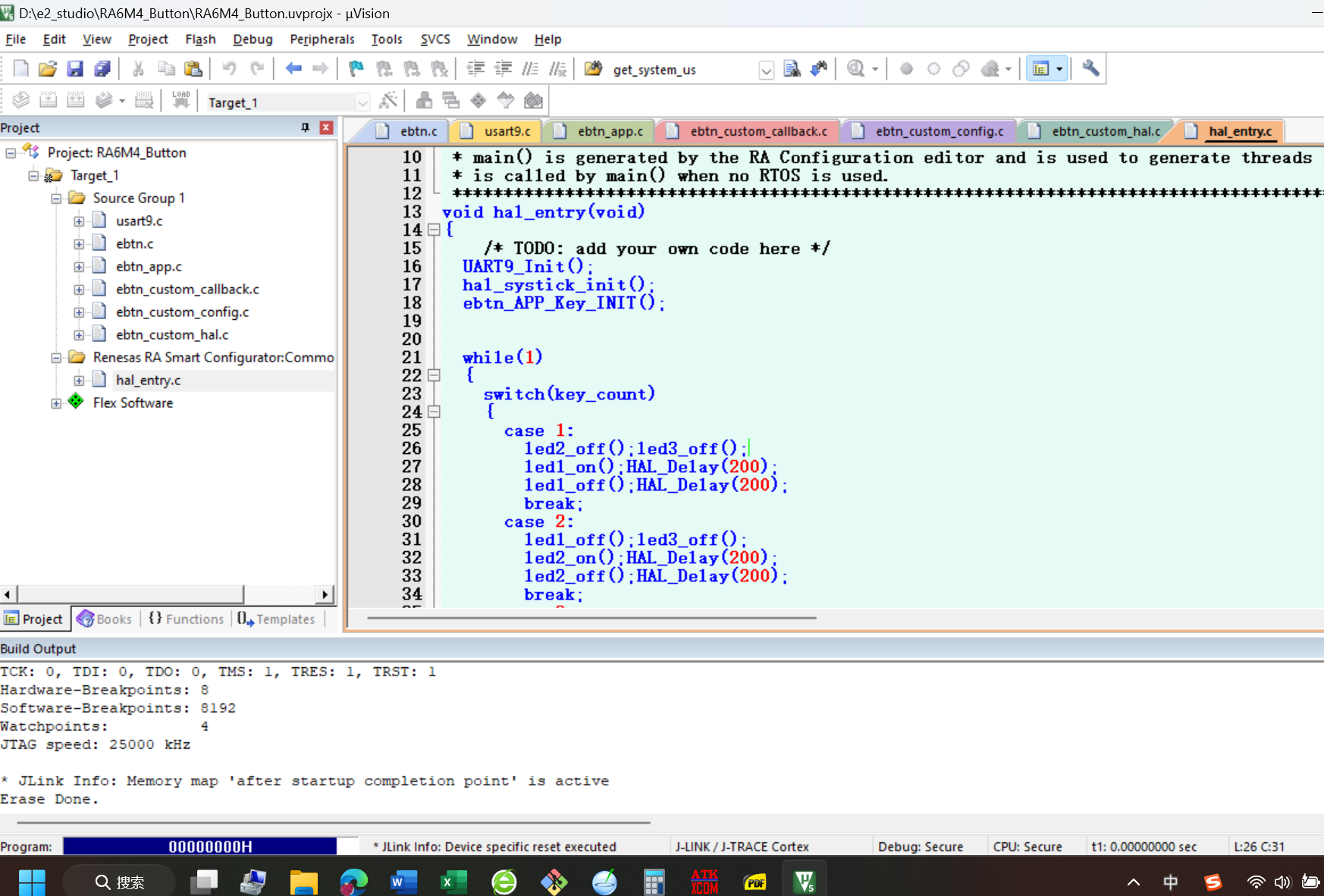

5。打开KEIL
修改核心代码

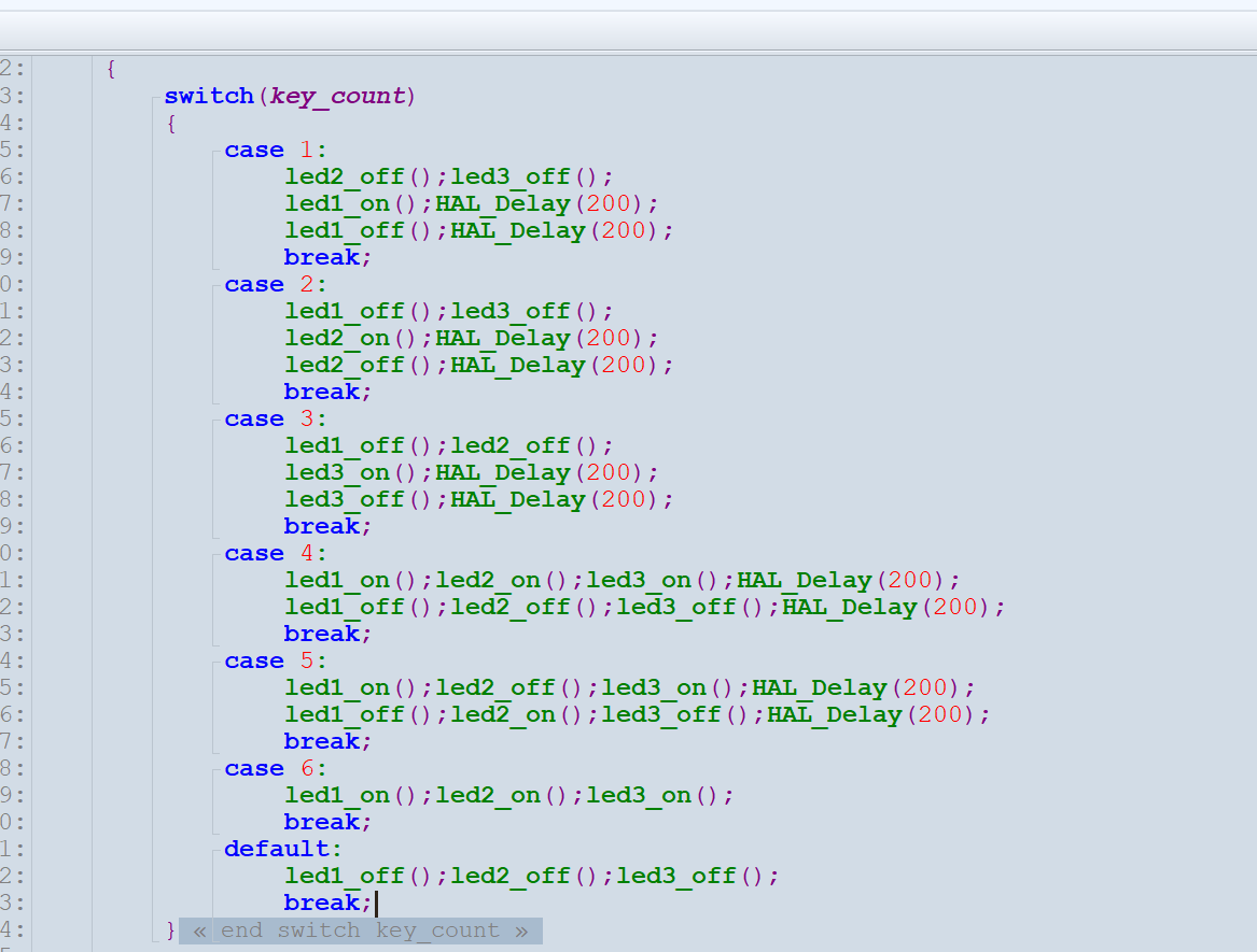

#define LED1_lighting_off R_IOPORT_PinWrite(&g_ioport_ctrl,LED1,BSP_IO_LEVEL_LOW)
#define LED1_lighting_up R_IOPORT_PinWrite(&g_ioport_ctrl,LED1,BSP_IO_LEVEL_HIGH)
#define LED2_lighting_off R_IOPORT_PinWrite(&g_ioport_ctrl,LED2,BSP_IO_LEVEL_LOW)
#define LED2_lighting_up R_IOPORT_PinWrite(&g_ioport_ctrl,LED2,BSP_IO_LEVEL_HIGH)
#define LED3_lighting_off R_IOPORT_PinWrite(&g_ioport_ctrl,LED3,BSP_IO_LEVEL_LOW)
#define LED3_lighting_up R_IOPORT_PinWrite(&g_ioport_ctrl,LED3,BSP_IO_LEVEL_HIGH)
static int led_state1 = 0;
static int led_state2 = 0;
static int led_state3 = 0;
void led1_on(void)
LED1_lighting_up;
led_state1 = 1;
void led1_off(void)
LED1_lighting_off;
led_state1 = 0;
void led2_on(void)
LED2_lighting_up;
led_state2 = 1;
void led2_off(void)
LED2_lighting_off;
led_state2 = 0;
void led3_on(void)
LED3_lighting_up;
led_state3 = 1;
void led3_off(void)
LED3_lighting_off;
led_state3 = 0;
int get_led1_status(void)
return led_state1;
int get_led2_status(void)
return led_state2;
int get_led3_status(void)
return led_state3;

/ ----------------------------------- 单击时 ---------------------------------- */
if (btn->click_cnt == 1)
printf("KEY_1 单击\r\n");
key_count++;
if(key_count>=7)key_count=0;
else if (btn->click_cnt == 2)
printf("KEY_1 双击\r\n");
key_count += 2;
else if (btn->click_cnt == 3)
printf("KEY_1 三击\r\n");
key_count += 3;
else if (evt == EBTN_EVT_KEEPALIVE)
if (btn->keepalive_cnt == 1)
key_count++;if(key_count>=7)key_count=0;
printf("KEY_1 长按\r\n");
break;

case COMBO_KEY_1:
/* ---------------------------------- 按下按键时 --------------------------------- /
if (evt == EBTN_EVT_ONPRESS)
printf("按组合按键KEY1 KEY2 \r\n");

主函数添加核心代码
#include "hal_data.h"
#include "usart9.h"
#include "ebtn_app.h"
FSP_CPP_HEADER
void R_BSP_WarmStart(bsp_warm_start_event_t event);
FSP_CPP_FOOTER
main() is generated by the RA Configuration editor and is used to generate threads if an RTOS is used. This function
is called by main() when no RTOS is used.
void hal_entry(void)
/ TODO: add your own code here */
UART9_Init();
hal_systick_init();
ebtn_APP_Key_INIT();
while(1)
switch(key_count)
case 1:
led2_off();led3_off();
led1_on();HAL_Delay(200);
led1_off();HAL_Delay(200);
break;
case 2:
led1_off();led3_off();
led2_on();HAL_Delay(200);
led2_off();HAL_Delay(200);
break;
case 3:
led1_off();led2_off();
led3_on();HAL_Delay(200);
led3_off();HAL_Delay(200);
break;
case 4:
led1_on();led2_on();led3_on();HAL_Delay(200);
led1_off();led2_off();led3_off();HAL_Delay(200);
break;
case 5:
led1_on();led2_off();led3_on();HAL_Delay(200);
led1_off();led2_on();led3_off();HAL_Delay(200);
break;
case 6:
break;
default:
break;

编译烧录代码到RA6M4板子
打开串口助手
可以看到实现了
KEY1的单击,双击,三击,长按
KEY2的单击,双击,三击,长按
KEY1和KEY2的组合按键
功能已经非常齐全,达到了第一水平!!!!!!
