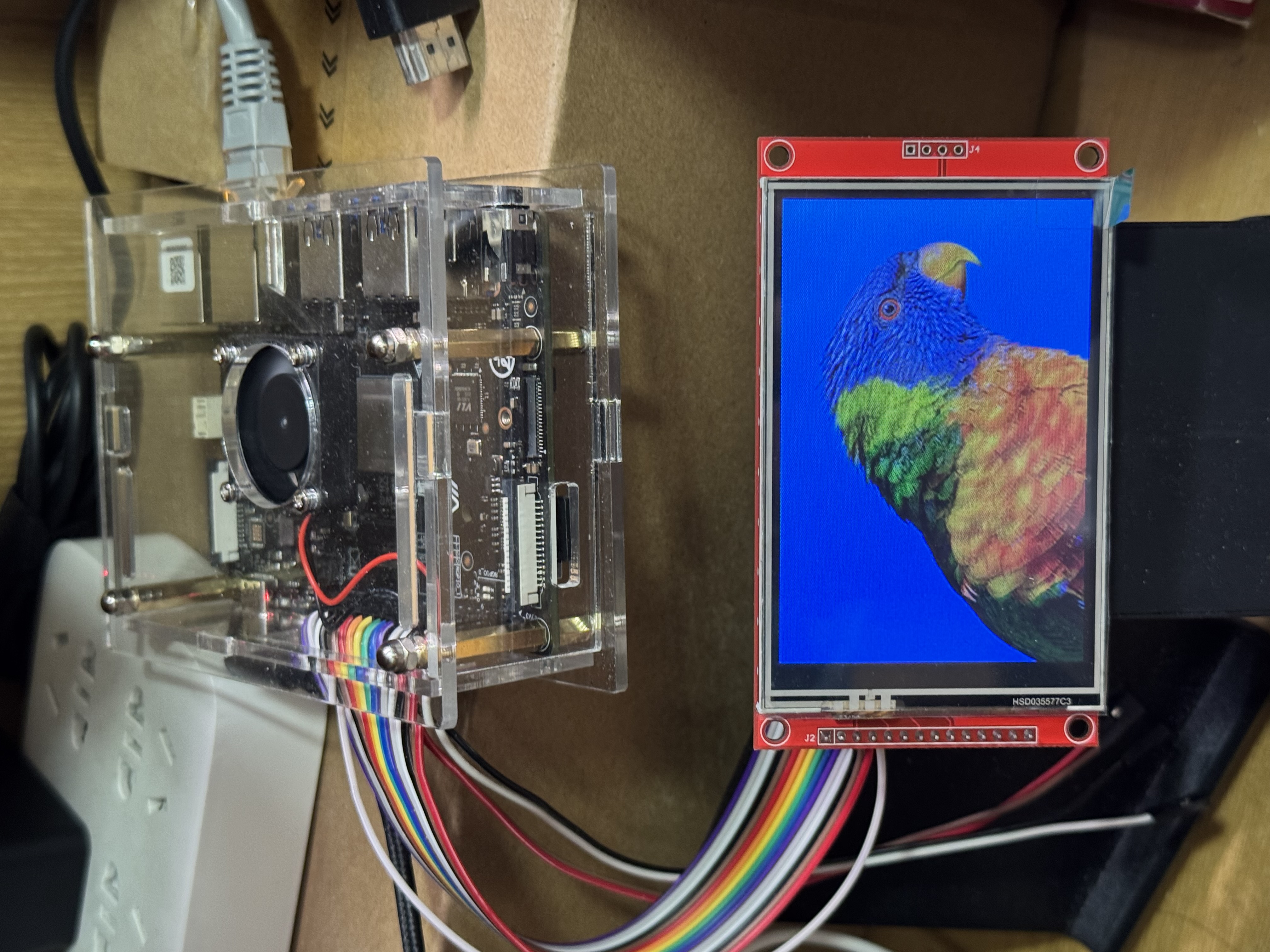

本章整理下我适配的三款lcd。
前两款ST7735|GC9306相对简单。
ILI9488由于色彩位深RGB666,需要从RGB888转为RGB666,同时需要注意采用比例计算颜色,如果采用
LCD_demo.py
Please make sure the 2.4inch LCD Moudle is connected to the correct pins.
The following table describes how to connect the 2.4inch LCD Module to the 40-pin header.
__2.4inch LCD Module___Pin Number_____Pin Name
VCC 17 3.3 V Power
GND 39 GND
DIN 19 SPI MOSI
CLK 23 SPI SCLK
CS 13 GPIO43 y
DC 11 GPIO42 y -
RST 07 GPIO55 y -
BL 15 GPIO47 y

Init
WHITE = 0xffffff
BLUE = 0xFF0000
lcd_num = 3
pin_res = 7
pin_dc = 11
vf_t = board_t.boardtype()
print("vf_t ",vf_t)
if vf_t == 1:
SPI_DEVICE = "/dev/spidev0.0"
elif vf_t == 2:
SPI_DEVICE = "/dev/spidev1.0"
else:
print("This module can only be run on a VisionFive board!")
"""The initialization settings of 2inch and 2.4inch are distinguished"""
match lcd_num:
case 1:
print("lcd st7735")
disp = LCD_ST7735_lib.LCD_ST7735(7, 11, SPI_DEVICE)
disp.lcd_init_st7735()
case 2:
print("lcd gc9306")
disp = LCD_GC9306_lib.LCD_GC9306(7, 11, SPI_DEVICE)
disp.lcd_init_gc9306()
case 3:
print("lcd ili9488")
disp = LCD_ILI9488_lib.LCD_ILI9488(7, 11, SPI_DEVICE)
disp.lcd_init_ili9488()
case _:
print("unknown lcd")
folder_path = "./picture"

def Image_to_RGB666(self, Image):
img = np.asarray(Image)
pix = np.zeros((self.width, self.height, 3), dtype=np.uint8)
pix[..., 0] = np.right_shift(img[..., 0], 2)
pix[..., 1] = np.right_shift(img[..., 1], 2)
pix[..., 2] = np.right_shift(img[..., 2], 2)
return pix
def Image_RGB888_to_RGB666(self, Image):
pix = np.zeros((self.height, self.width, 3), dtype=np.uint8)
pix[..., [0]] = np.left_shift(np.left_shift(img[..., [0]], 2), 2)
pix[..., [1]] = np.left_shift(np.left_shift(img[..., [1]], 2), 2)
pix[..., [2]] = np.left_shift(np.left_shift(img[..., [2]], 2), 2)
return pix.flatten().tolist()

if Image.mode == "RGBA":
Image = Image.convert("RGB")
if imwidth == self.height and imheight == self.width:
img_array = np.asarray(Image, dtype=np.uint8)
scale_factor = 63 * 4 / 255
pix = np.round(img_array * scale_factor).astype(np.uint8)
pix = pix.flatten().tolist()
self.lcd_sendcmd(
0x36
self.lcd_senddata(0x68)
self.lcd_setPos(0, 0, self.height, self.width)
gpio.output(self.pin_dc, gpio.HIGH)
"""modify the original single byte write to multi byte write"""
self.lcd_sendnbytes(pix)
else:
print("same direction")
self.lcd_sendcmd(0x36)
self.lcd_senddata(0x88)
self.lcd_setPos(0, 0, self.width, self.height)

效果我就放ILI9488的了,st7735见上一篇。
