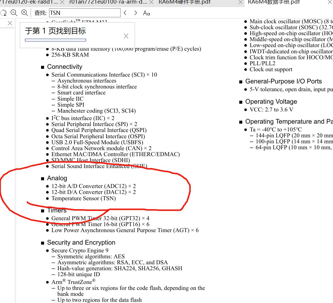

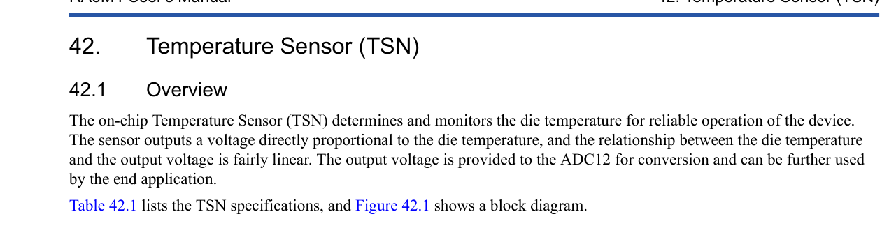

打开RA6M4数据手册

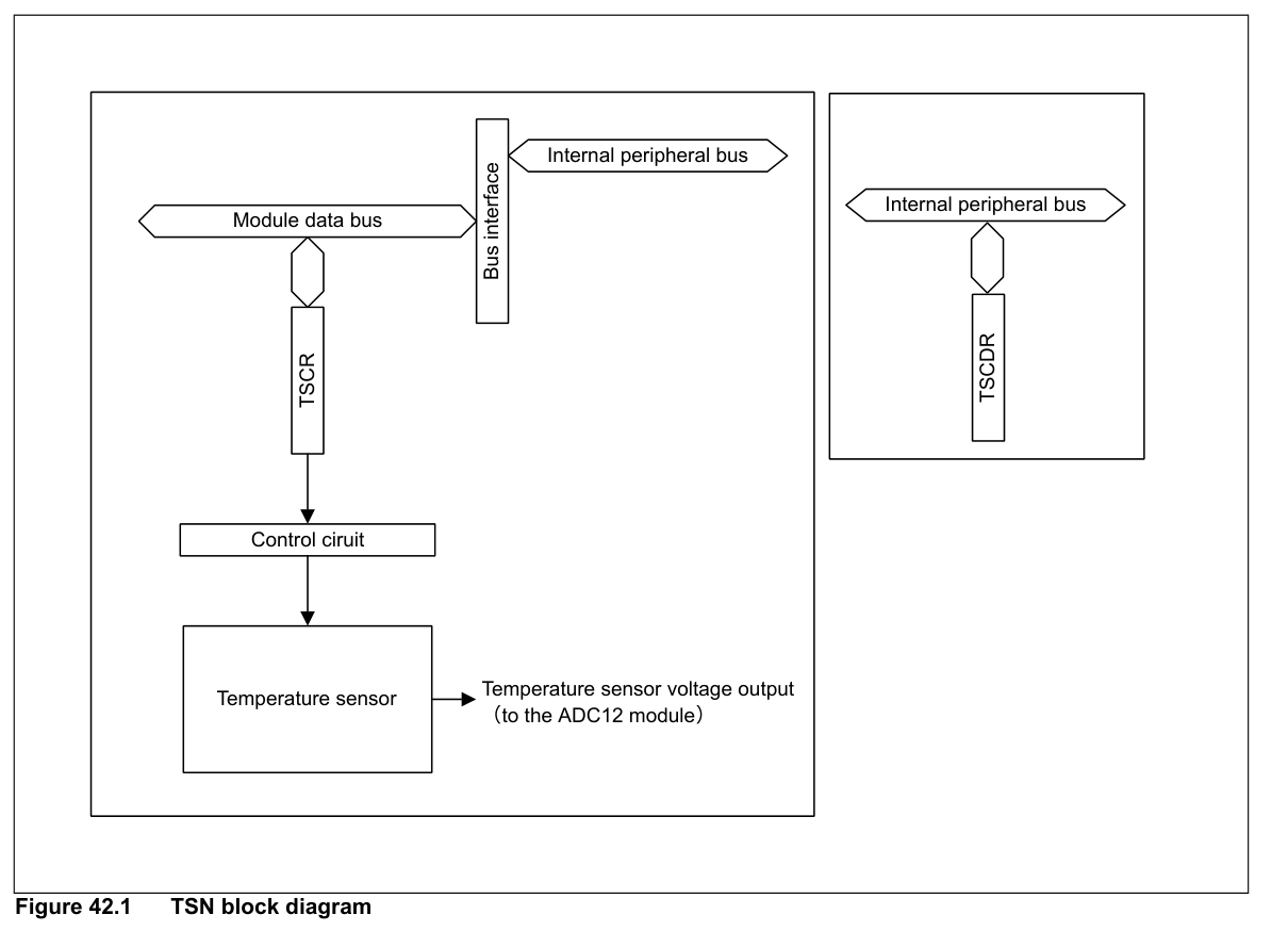

上面着重介绍了Temperature Sensor (TSN)
可以测量MCU的内部温度

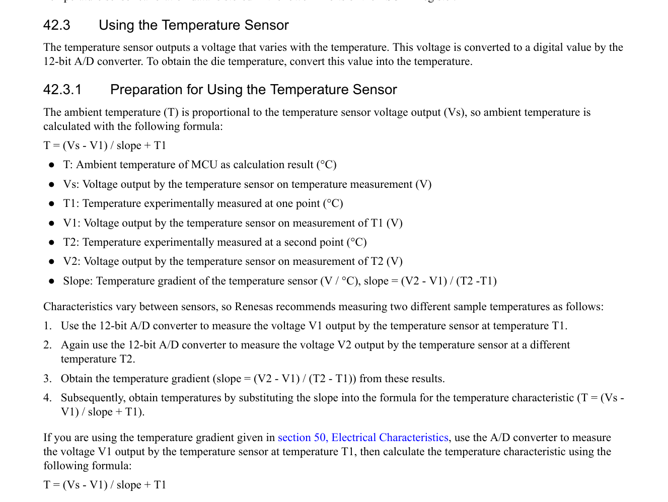

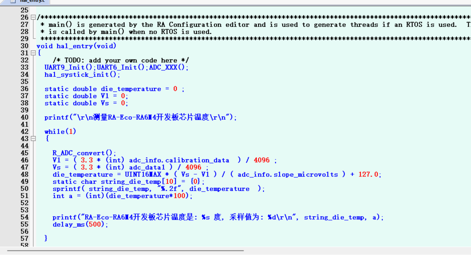

TSN结构如下:

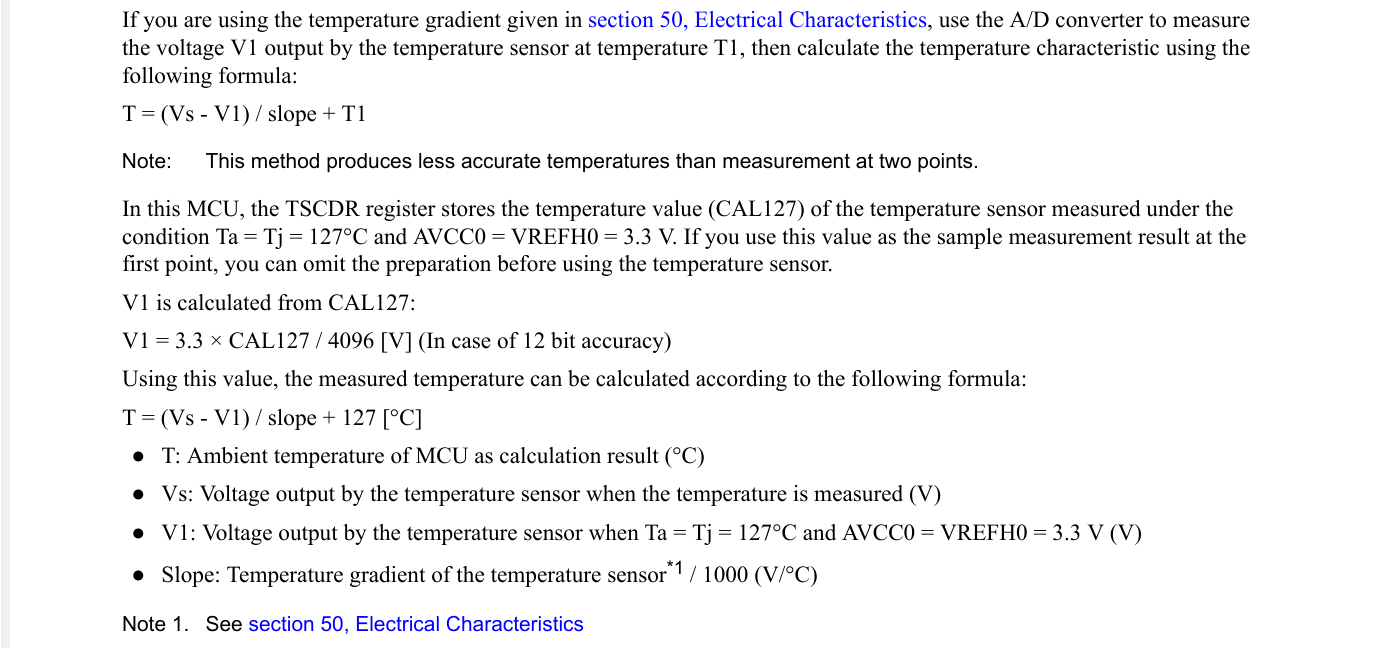

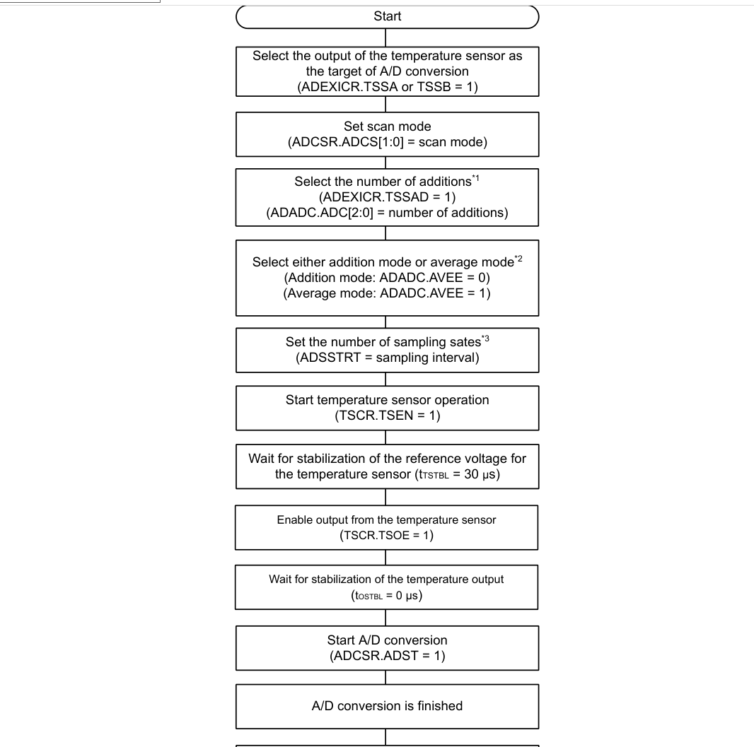

使用TSN计算ADC温度值的公式
计算流程图
只要严格按照几张图操作,就可以非常简单的计算出RA6M4的内部温度值

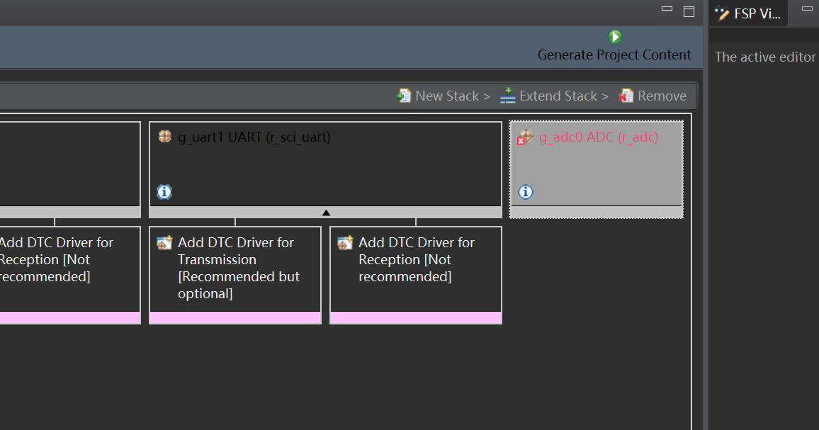

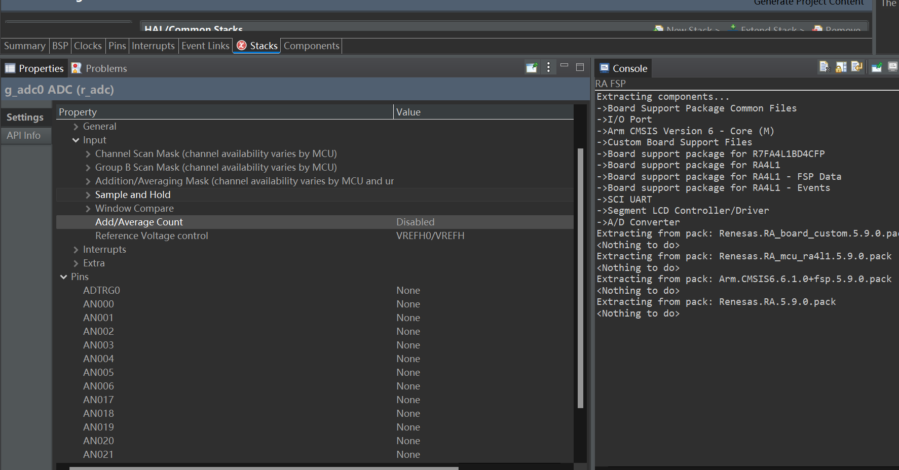

1。打开瑞萨的RA Smart 配置软件
配置好后,生成代码

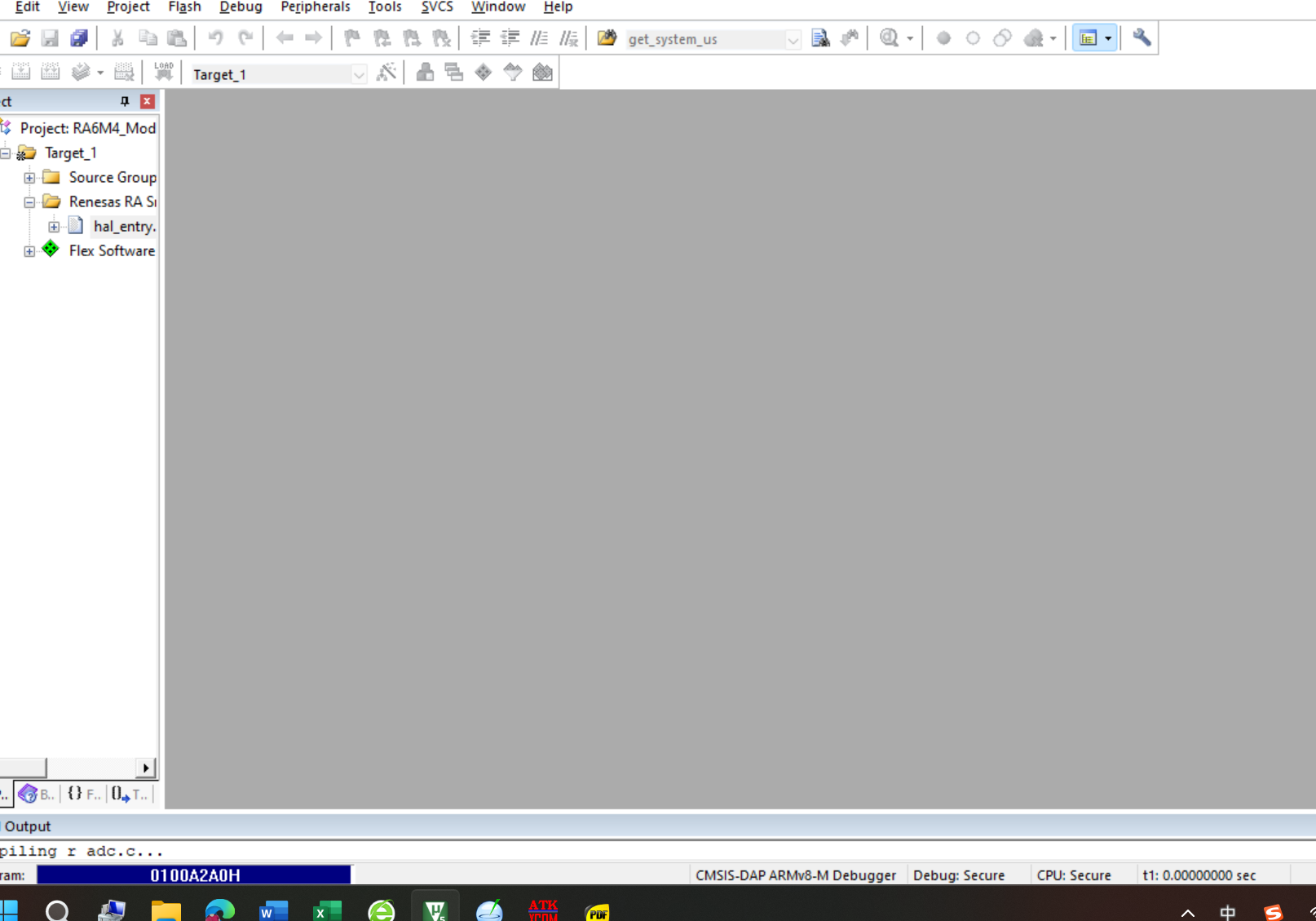

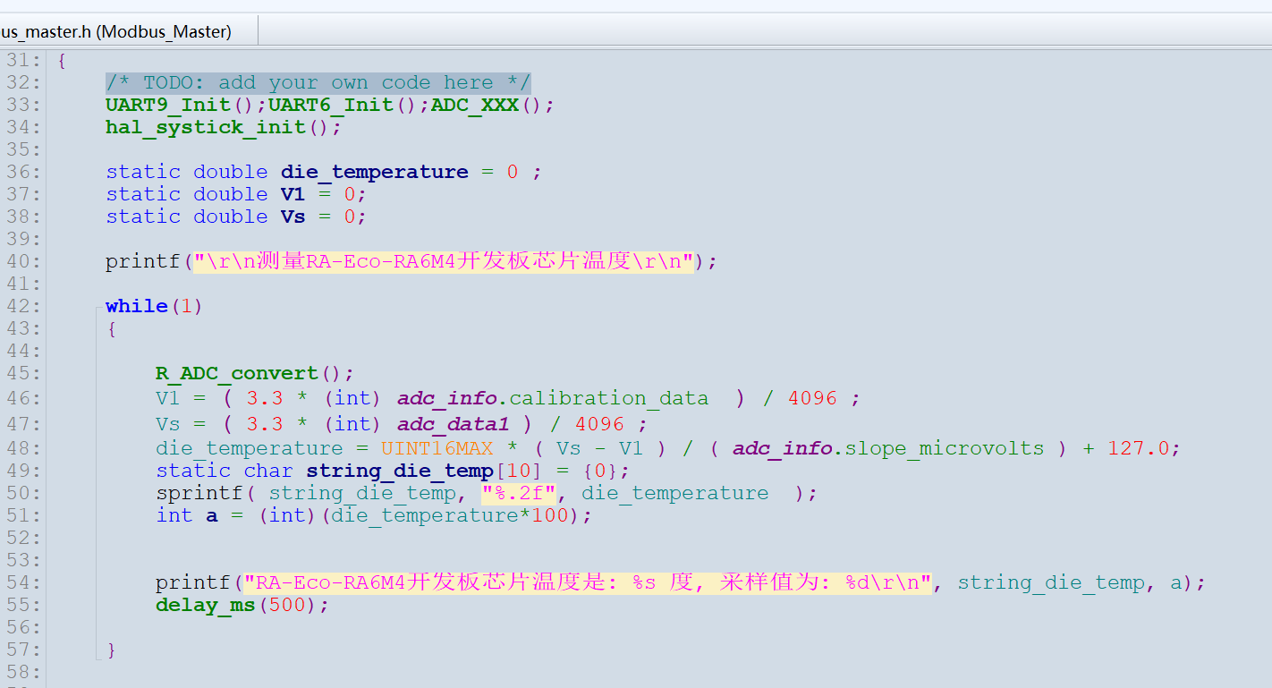

2。打开KEIL工程,添加核心代码
#include "hal_data.h"
#include "usart9.h"
#include "usart6.h"
#include "modbus_master.h"
FSP_CPP_HEADER
void R_BSP_WarmStart(bsp_warm_start_event_t event);
FSP_CPP_FOOTER
void SysTick_Handler(void )
SysTick_Inc();
volatile bool scan_complete_flag = false;
void adc_callback (adc_callback_args_t * p_args)
FSP_PARAMETER_NOT_USED(p_args);
scan_complete_flag = true;
static adc_info_t adc_info ; //adc information
uint16_t adc_data1=0;
main() is generated by the RA Configuration editor and is used to generate threads if an RTOS is used. This function
is called by main() when no RTOS is used.
void hal_entry(void)
/ TODO: add your own code here */
UART9_Init();UART6_Init();ADC_XXX();
hal_systick_init();
static double die_temperature = 0 ;
static double V1 = 0;
static double Vs = 0;
printf("\r\n测量RA-Eco-RA6M4开发板芯片温度\r\n");
while(1)
R_ADC_convert();
V1 = ( 3.3 * (int) adc_info.calibration_data ) / 4096 ;
Vs = ( 3.3 * (int) adc_data1 ) / 4096 ;
die_temperature = UINT16MAX * ( Vs - V1 ) / ( adc_info.slope_microvolts ) + 127.0;

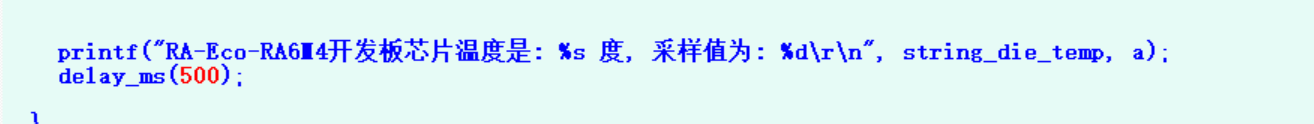

static char string_die_temp[10] = {0};
sprintf( string_die_temp, "%.2f", die_temperature );
int a = (int)(die_temperature*100);
printf("RA-Eco-RA6M4开发板芯片温度是: %s 度, 采样值为: %d\r\n", string_die_temp, a);
delay_ms(500);
uint8_t state=0;
uint16_t Input_Result[2];
ModbusMaster_begin();
while(1)
uint8_t result;
result = ModbusMaster_readInputRegisters(0x01,0x2, 2);
if (result == 0x00)
Input_Result[0] = ModbusMaster_getResponseBuffer(0x00);
Input_Result[1] = ModbusMaster_getResponseBuffer(0x01);
R_BSP_SoftwareDelay(100, BSP_DELAY_UNITS_MILLISECONDS);
#if BSP_TZ_SECURE_BUILD
/* Enter non-secure code */
R_BSP_NonSecureEnter();
#endif
看到没,代码和计算公式一模一样,看个人的理解水平了。

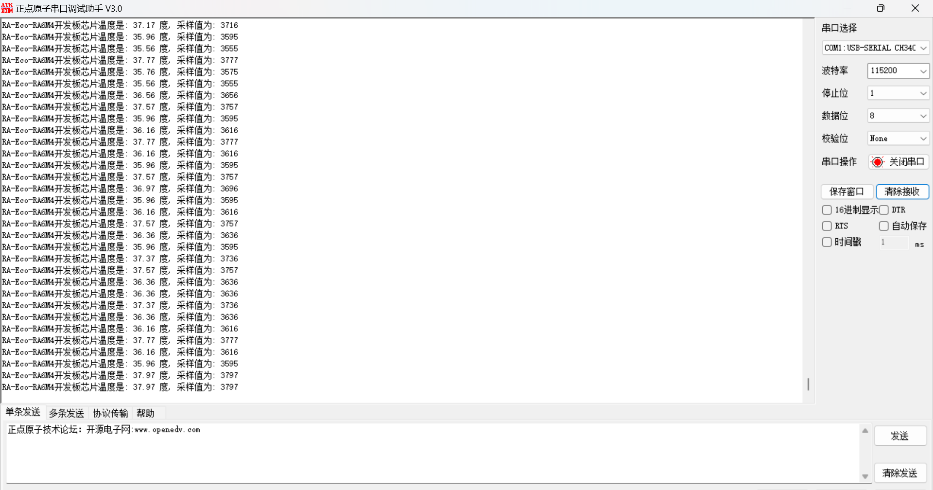

好了,编译后烧录代码到RA6M4板子
打开窗口助手
可以看到现在RA6M4的内部温度是36度到37度之间,非常的准确!!!!
