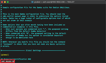

# vim需要右键输入
:set mouse-=a

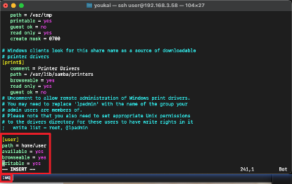

sudo vim /etc/samba/smb.conf
[user]
path = home/user
available = yes
browseable = yes
writable = yes

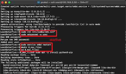

sudo smbpasswd -a user
sudo service smbd restart

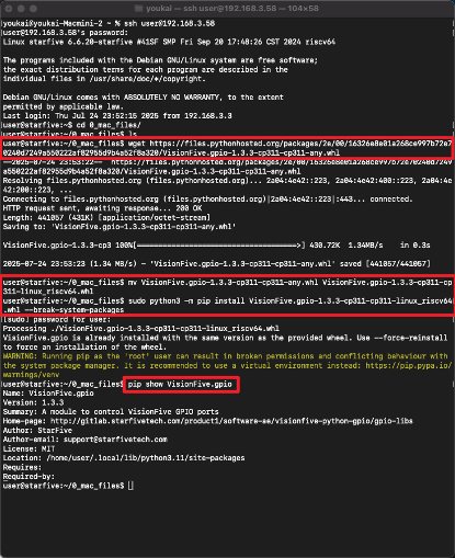

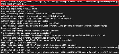

3.2 安装python库
sudo apt -y install python3-pip libxml2-dev libxslt-dev python3-requests python3-wget python3-bs4 python3-pillow python3-numpy
wget https://files.pythonhosted.org/packages/2e/00/16326e8e01a268ce997b72e70240d7249a550222af82955d9b4a52f8a320/VisionFive.gpio-1.3.3-cp311-cp311-any.whl
mv VisionFive.gpio-1.3.3-cp311-cp311-any.whl VisionFive.gpio-1.3.3-cp311-cp311-linux_riscv64.whl
sudo python3 -m pip install VisionFive.gpio-1.3.3-cp311-cp311-linux_riscv64.whl --break-system-packages
pip show VisionFive.gpio

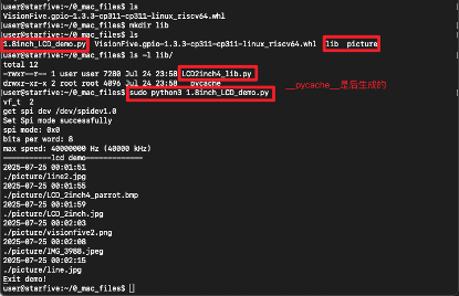

3.3 运行
创建1.8inch_LCD_demo.py文件、lib/LCD2inch4_lib.py库文件以及picture文件夹。
代码在下一章节

1.8inch_LCD_demo.py
Please make sure the 2.4inch LCD Moudle is connected to the correct pins.
The following table describes how to connect the 2.4inch LCD Module to the 40-pin header.
__2.4inch LCD Module___Pin Number_____Pin Name
VCC 17 3.3 V Power
GND 39 GND
DIN 19 SPI MOSI
CLK 23 SPI SCLK
CS 13 GPIO43 y
DC 11 GPIO42 y -
RST 07 GPIO55 y -
BL 15 GPIO47 y
import os
import sys
import time
import logging
from PIL import Image
sys.path.append("..")
import VisionFive.boardtype as board_t
from lib import LCD2inch4_lib
Demo modification ans new function description
I. add the clear() function to fill LCD screen with white
II. give a hexadecimal value of white
III. cycle through multiple pictures
Init
WHITE = 0xffff
vf_t = board_t.boardtype()
print("vf_t ",vf_t)
if vf_t == 1:
SPI_DEVICE = "/dev/spidev0.0"
elif vf_t == 2:
SPI_DEVICE = "/dev/spidev1.0"
else:
print("This module can only be run on a VisionFive board!")
"""The initialization settings of 2inch and 2.4inch are distinguished"""
disp = LCD2inch4_lib.LCD_2inch4(7, 11, SPI_DEVICE)
disp.lcd_init_2inch4()
folder_path = "./picture"
items = os.listdir(folder_path)
file_paths = []
for item in items:
item_path = os.path.join(folder_path, item)
if os.path.isfile(item_path) and "._" not in item:
file_paths.append(item_path)
def show_img(image_path):
image = Image.open(image_path)
new_size = (128, 160)
resized_image = image.resize(new_size)
disp.lcd_ShowImage(resized_image, 0, 0)
time.sleep(2)
def test_clear():
disp.lcd_clear(WHITE)
print("clear screen")
time.sleep(2)
Black=0x001f
disp.lcd_clear(Black)
time.sleep(2)
def main():
print("-----------lcd demo-------------")
for path in file_paths:
print(time.strftime("%Y-%m-%d %H:%M:%S", time.localtime(time.time())))
path_tmp = path
print(path_tmp)
show_img(path_tmp)
time.sleep(2)
print("Exit demo!")
if __name__ == '__main__':
main()
