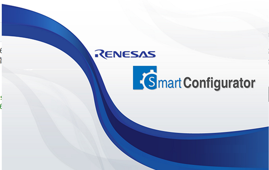

手头上有一个ESP8266,闲置了很久,突然想起来可以和RA6M4开发板连接起来,使用AT指令来获取网络天气预报,于是就把它们连接起来。就有了这个帖子。

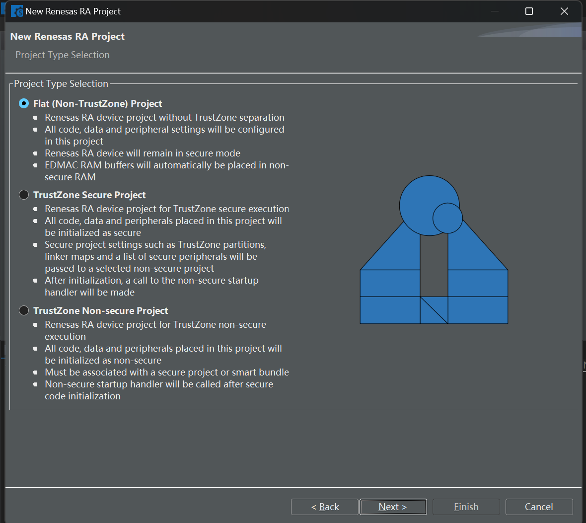

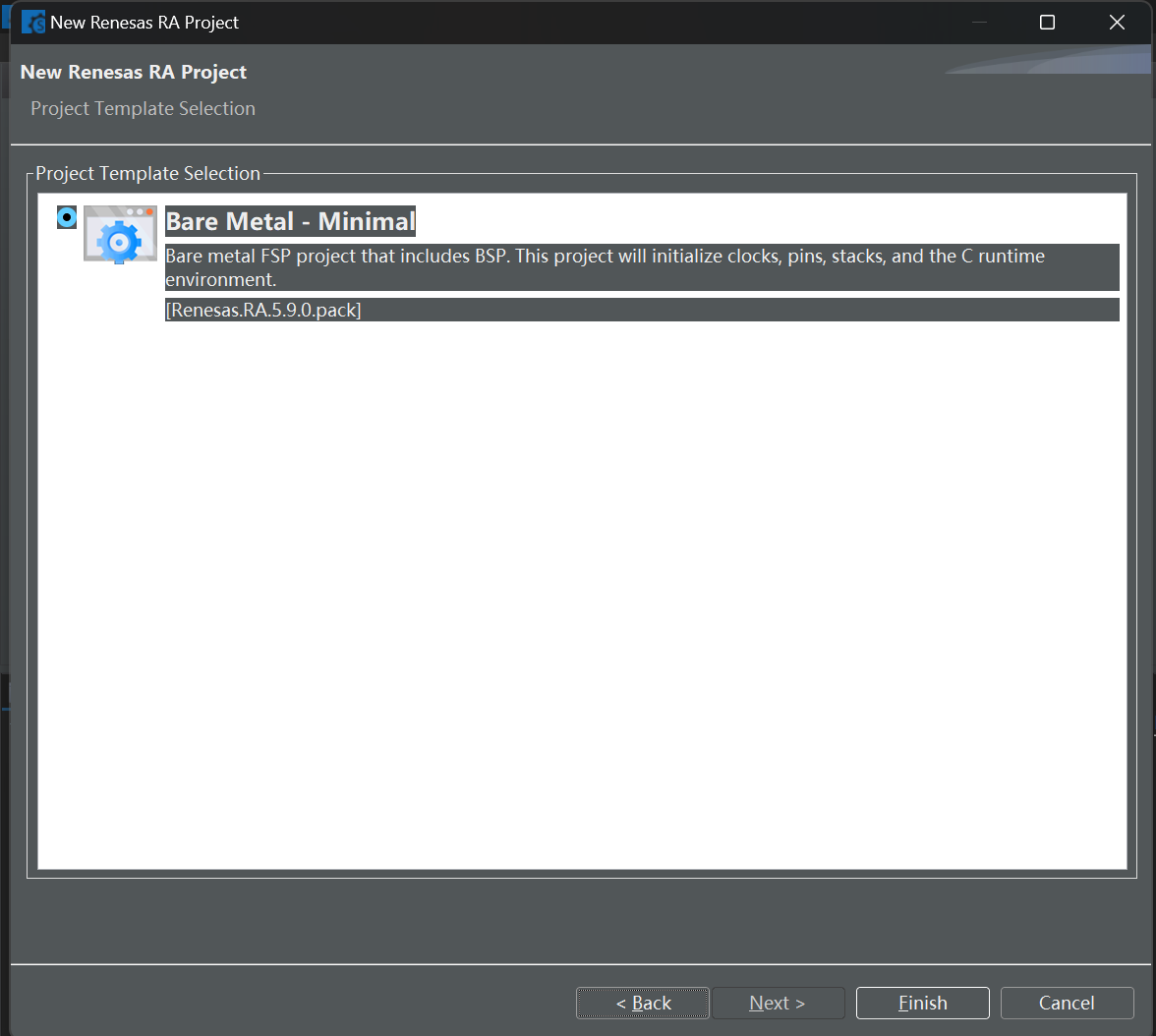

开始创建工程,打开
RA smart 配置软件

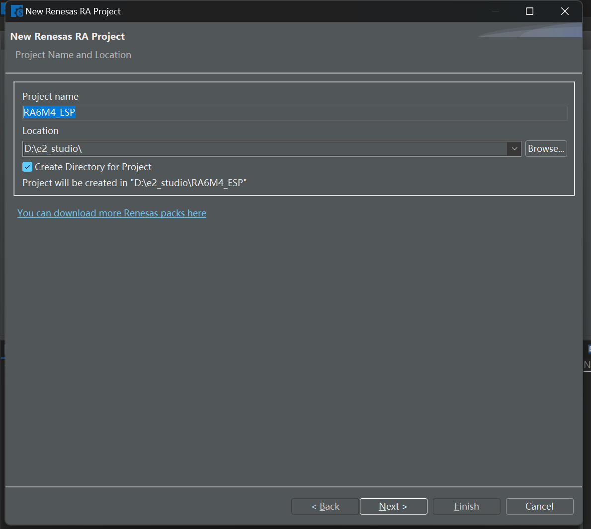

1.取名RA6M4_ESP

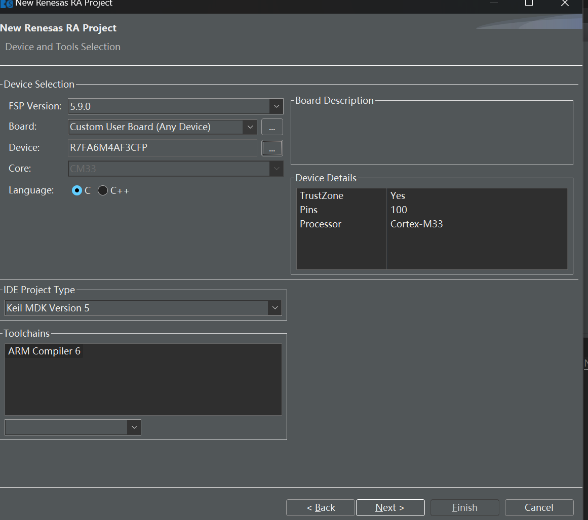

2。选择芯片

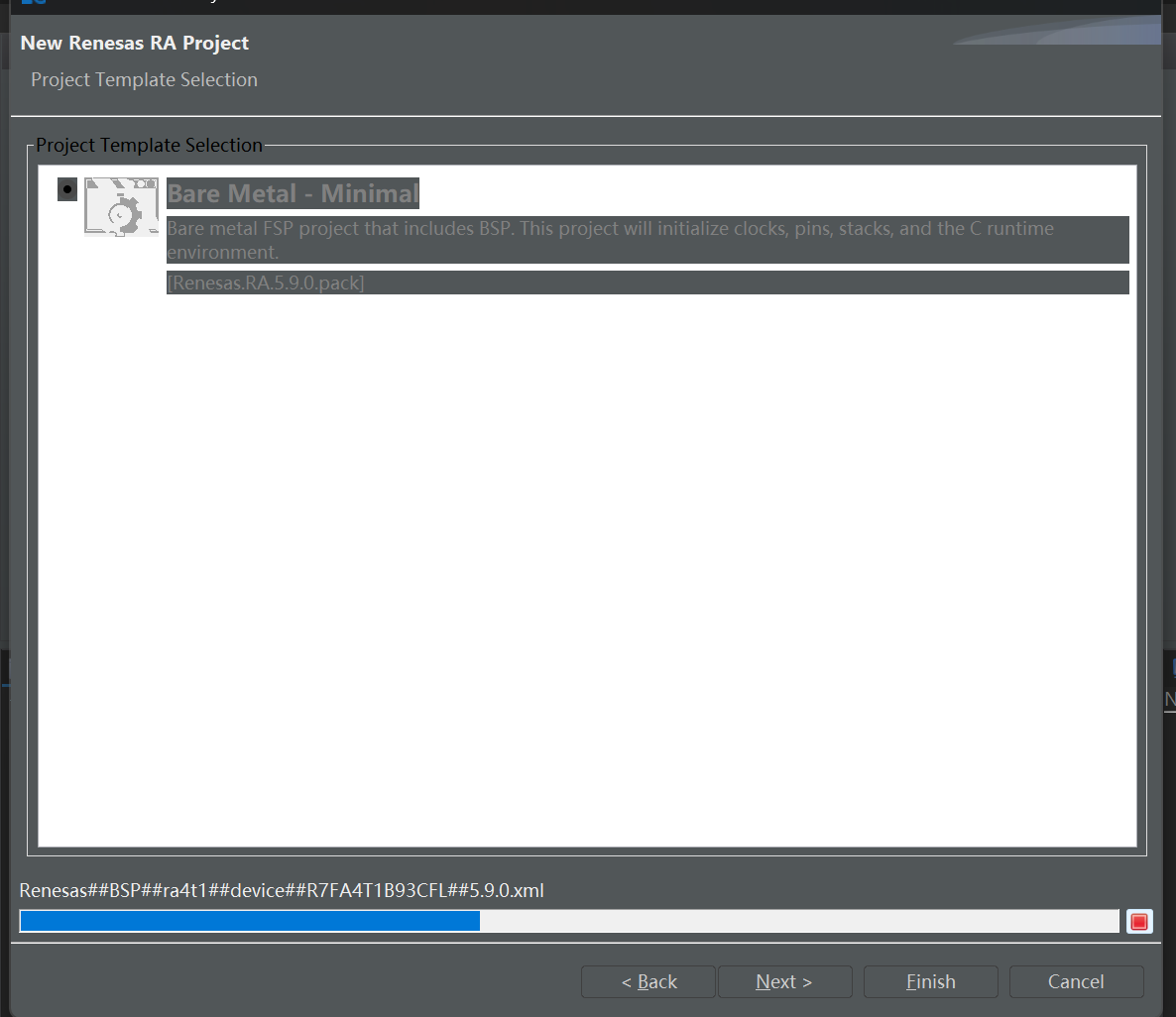

3。继续
4。finish完成

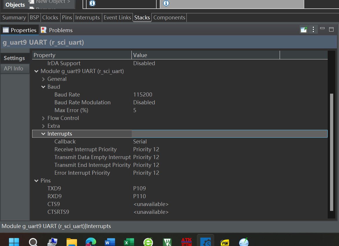

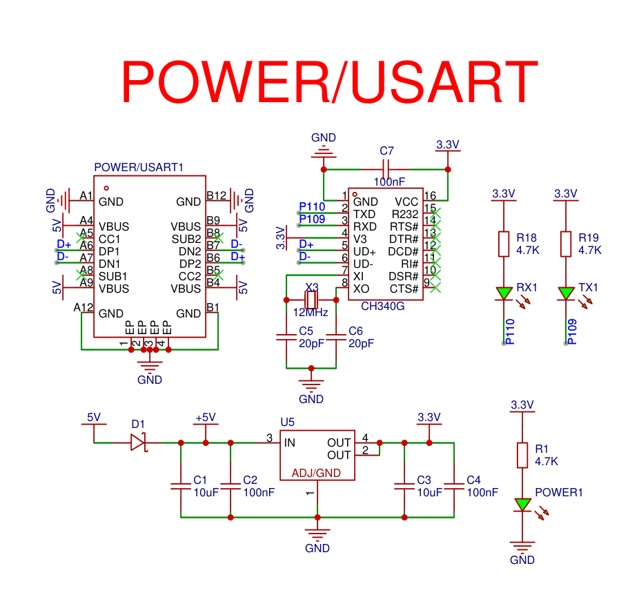

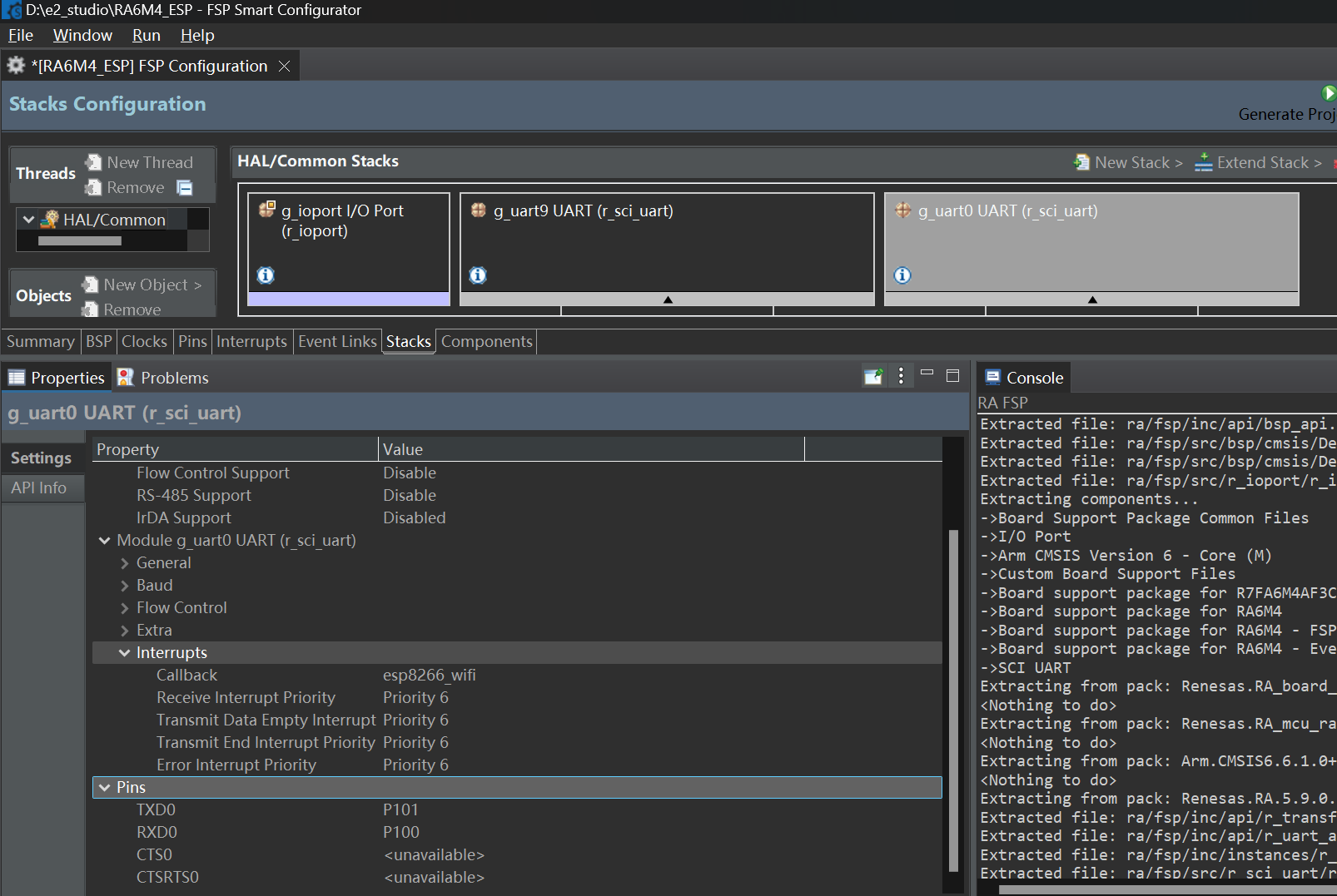

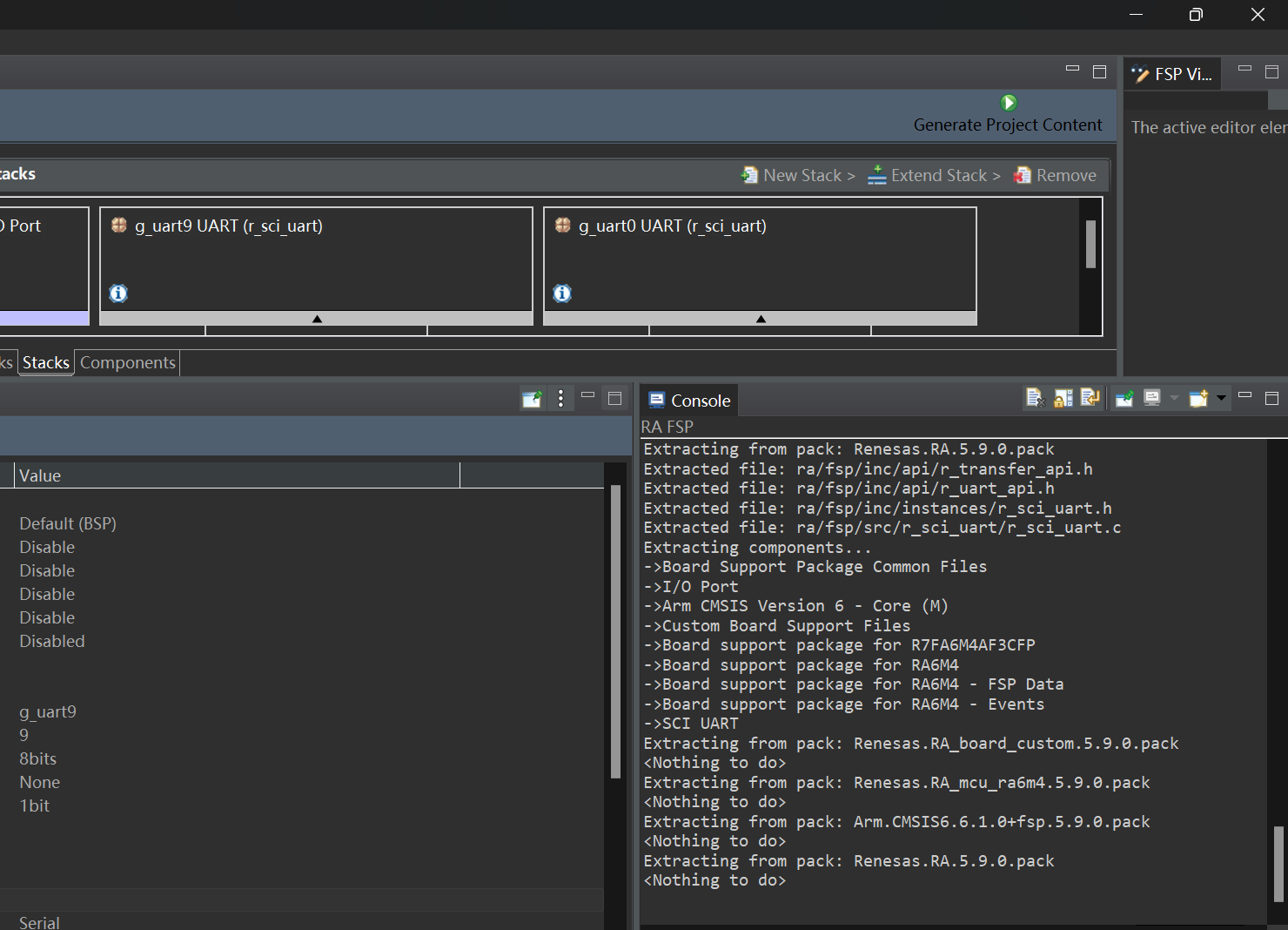

5。设置通信串口
首先P110和P109用来打印调试
配置好参数
ESP8266选择P100和P101

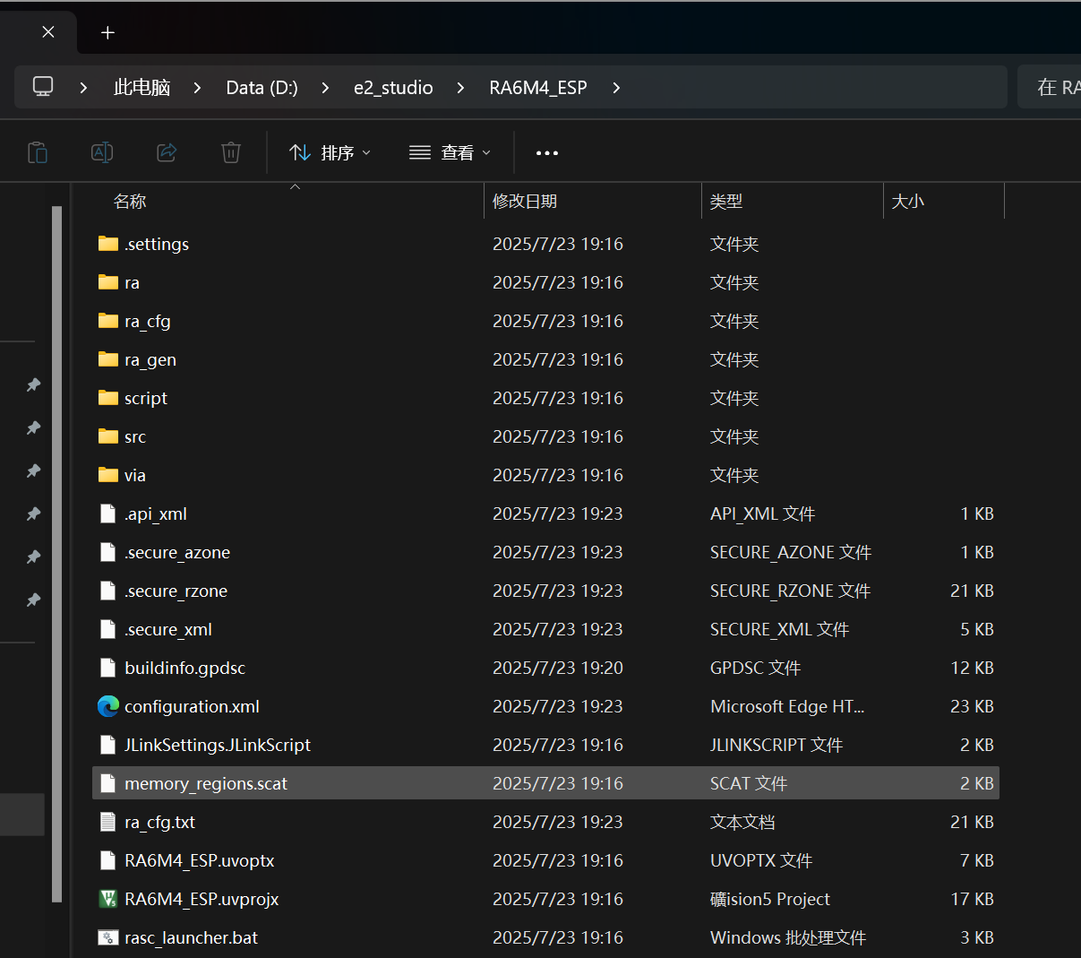

6。生成代码

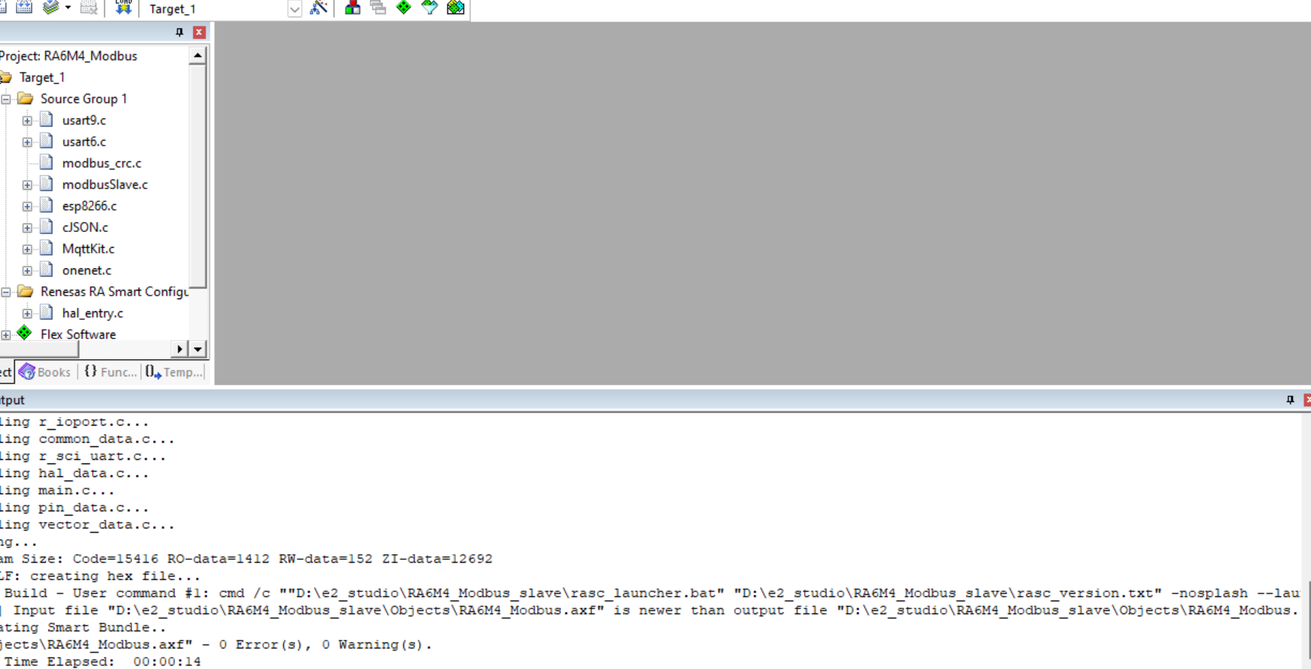

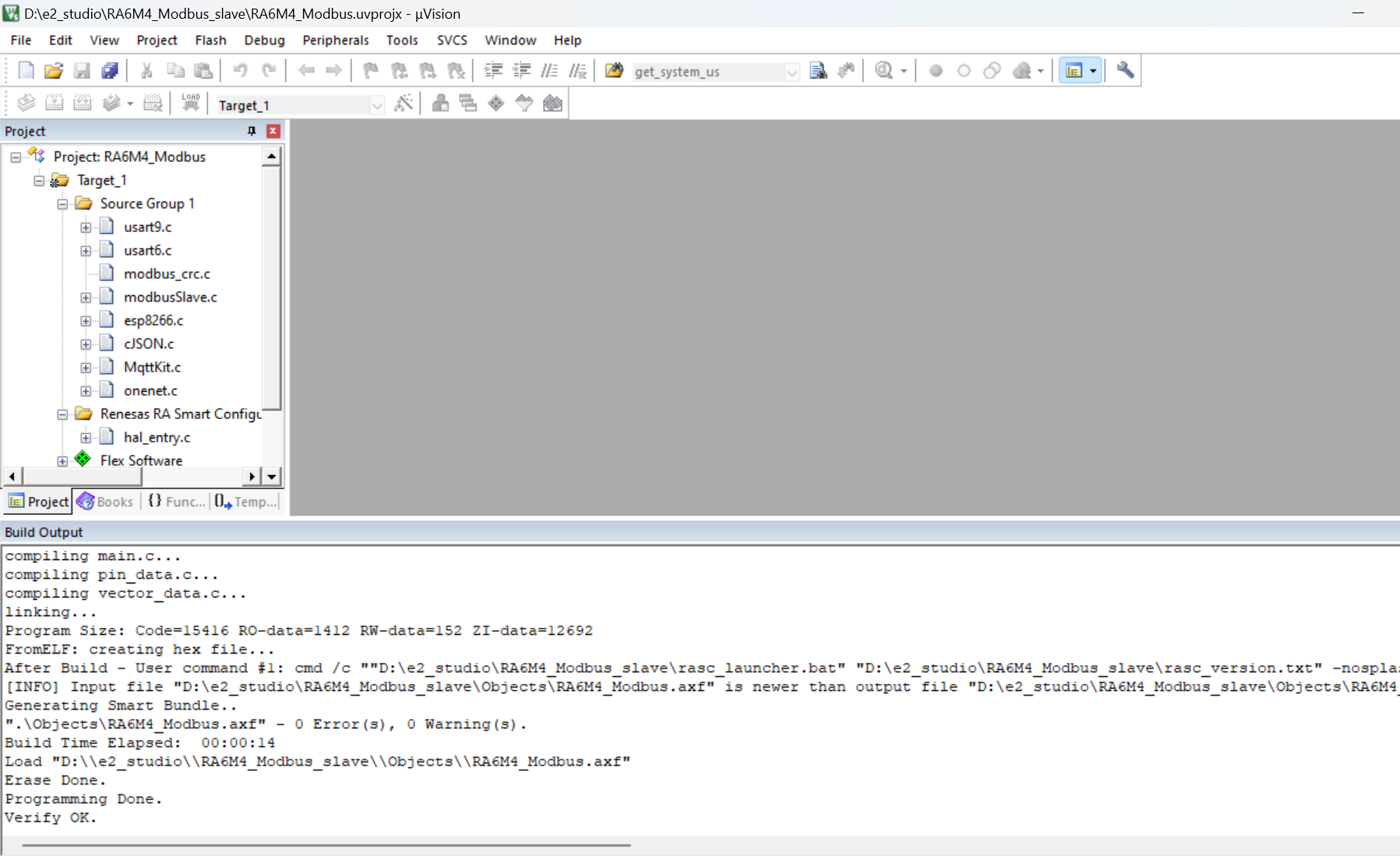

打开KEIL工程

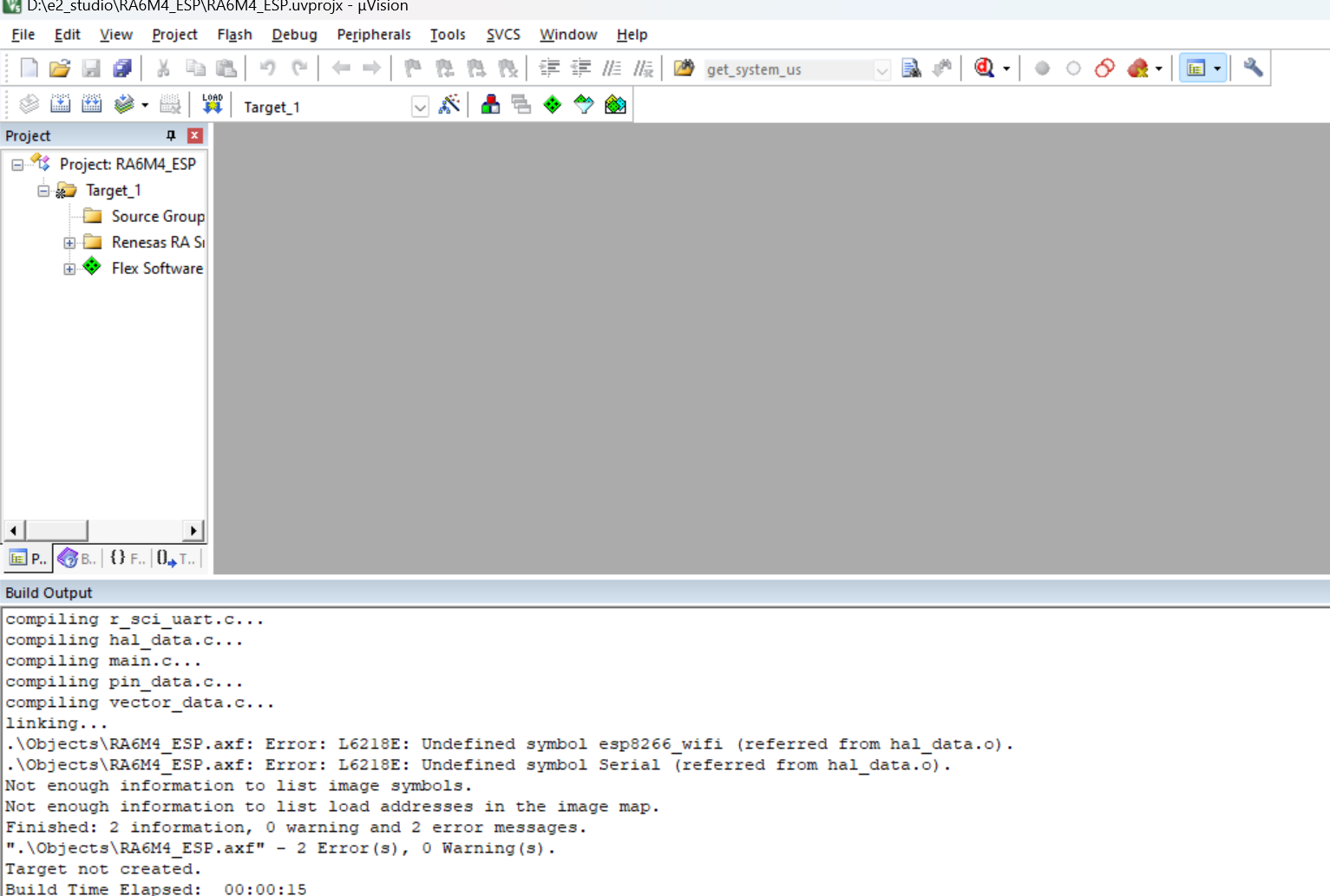

编译工程
两处报错,需要修改代码

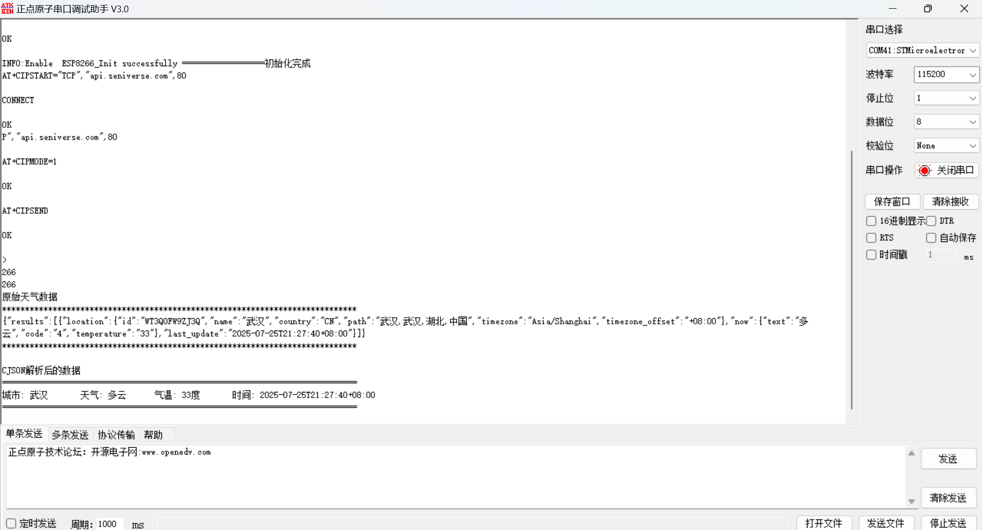

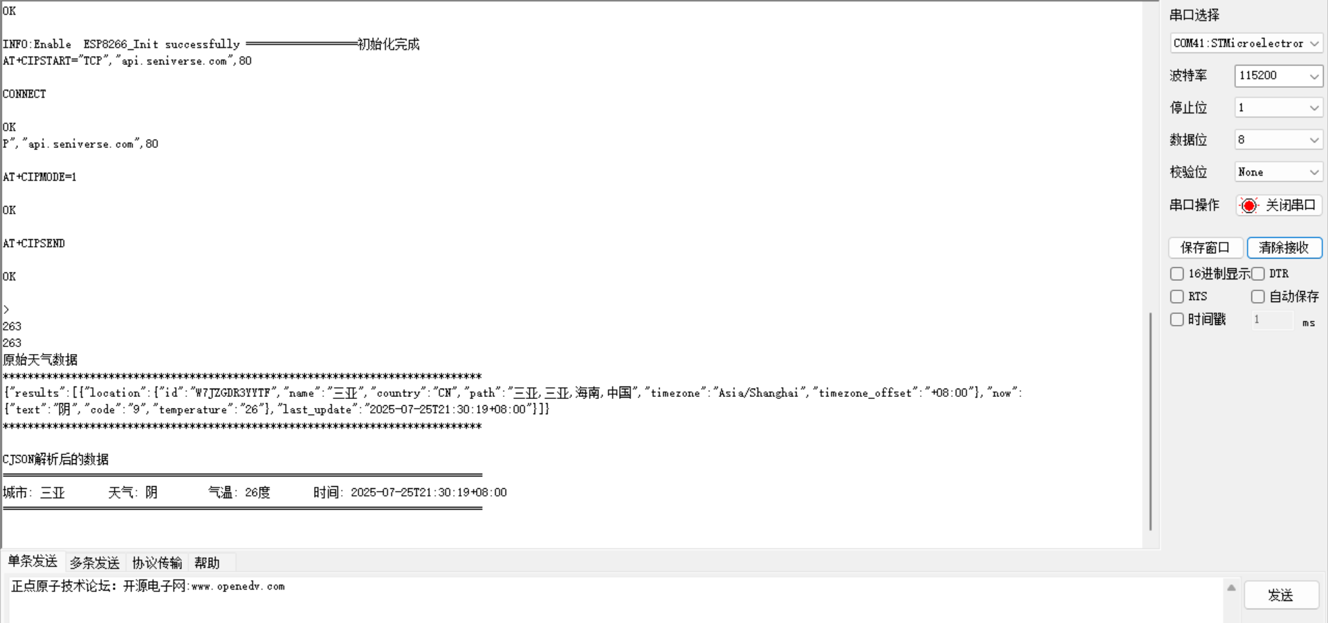

下面是获取天气预报核心代码
#include "hal_data.h"
#include "usart9.h"
#include "usart6.h"
#include "modbusSlave.h"
#include "esp8266.h"
#include "onenet.h"
#include "MqttKit.h"
#include "cJSON.h"
FSP_CPP_HEADER
void R_BSP_WarmStart(bsp_warm_start_event_t event);
FSP_CPP_FOOTER
void delay_ms(uint32_t ms)
R_BSP_SoftwareDelay(ms, BSP_DELAY_UNITS_MILLISECONDS);
uint16_t timeCount = 0;
char PUB_BUF[256];//上传数据的buf(温度,湿度,光照强度,LED和蜂鸣器)
const char *devSubTopic[] = {"LED"}; // 设备订阅命令地址,MQTTX发送命令到服务器,stm32接收命令
const char devPubTopic[] = "RA6M4-Temperature"; // 设备上行数据地址,stm32传感器向服务器传输数据并使用MQTTX接收
uint8_t alarmFlag;//是否报警的标志
uint8_t alarm_is_free;

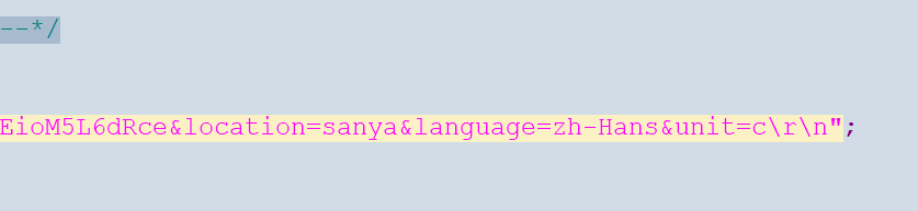

char TX_Data[]="GET https://api.seniverse.com/v3/weather/now.json?key=SfobYEEioM5L6dRce&location=wuhan&language=zh-Hans&unit=c\r\n";
char Data[]="AT+CIPSEND\r\n";
main() is generated by the RA Configuration editor and is used to generate threads if an RTOS is used. This function
is called by main() when no RTOS is used.

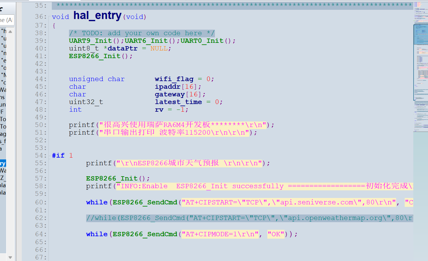

void hal_entry(void)
/ TODO: add your own code here */
UART9_Init();UART6_Init();UART0_Init();
uint8_t *dataPtr = NULL;
ESP8266_Init();
unsigned char wifi_flag = 0;
char ipaddr[16];
char gateway[16];
uint32_t latest_time = 0;
int rv = -1;
printf("很高兴使用瑞萨RA6M4开发板********\r\n");
printf("串口输出打印 波特率115200\r\n\r\n");
#if 1
printf("\r\nESP8266城市天气预报 \r\n\r\n");
ESP8266_Init();
printf("INFO:Enable ESP8266_Init successfully ==================初始化完成\r\n");
while(ESP8266_SendCmd("AT+CIPSTART=\"TCP\",\"api.seniverse.com\",80\r\n", "CONNECT\r\n"));
while(ESP8266_SendCmd("AT+CIPMODE=1\r\n", "OK"));
ESP8266_SendData(TX_Data,strlen(TX_Data));
delay_ms(500);
printf("%d\r\n",esp8266_cnt);
printf("%d\r\n",strlen(esp8266_buf));
printf("原始天气数据\r\n");
printf("*****************************************************************************\r\n");
printf("%s\r\n",esp8266_buf);
cJSON *json;
cJSON *Array_obj1;
cJSON *Array_obj2;
cJSON *Array_obj3;
cJSON *Array_obj4;
cJSON *Array_obj5;
cJSON *Array_obj6;
cJSON *Array_obj7;
cJSON *Array_obj8;
cJSON *Array;
json = cJSON_Parse((const char *) esp8266_buf );
Array_obj1=cJSON_GetObjectItem(json,"results");
int size=cJSON_GetArraySize(Array_obj1);
printf("\r\nCJSON解析后的数据\r\n");
printf("=============================================================================\r\n");
if(json == NULL)
printf("\njson fmt error:%s\n.", cJSON_GetErrorPtr());
else
Array=cJSON_GetArrayItem(Array_obj1,0);
Array_obj2=cJSON_GetObjectItem(Array,"now");
Array_obj3=cJSON_GetObjectItem(Array_obj2,"code");
Array_obj4=cJSON_GetObjectItem(Array_obj2,"temperature");

编译工程,烧录代码带RA6M4
打开串口助手
{"results":[{"location":{"id":"WT3Q0FW9ZJ3Q","name":"武汉","country":"CN","path":"武汉,武汉,湖北,中国","timezone":"Asia/Shanghai","timezone_offset":"+08:00"},"now":{"text":"多云","code":"4","temperature":"33"},"last_update":"2025-07-25T21:27:40+08:00"}]}
CJSON解析后的数据
城市: 武汉 天气: 多云 气温: 33度 时间: 2025-07-25T21:27:40+08:00
可以看到获取了武汉天气预报

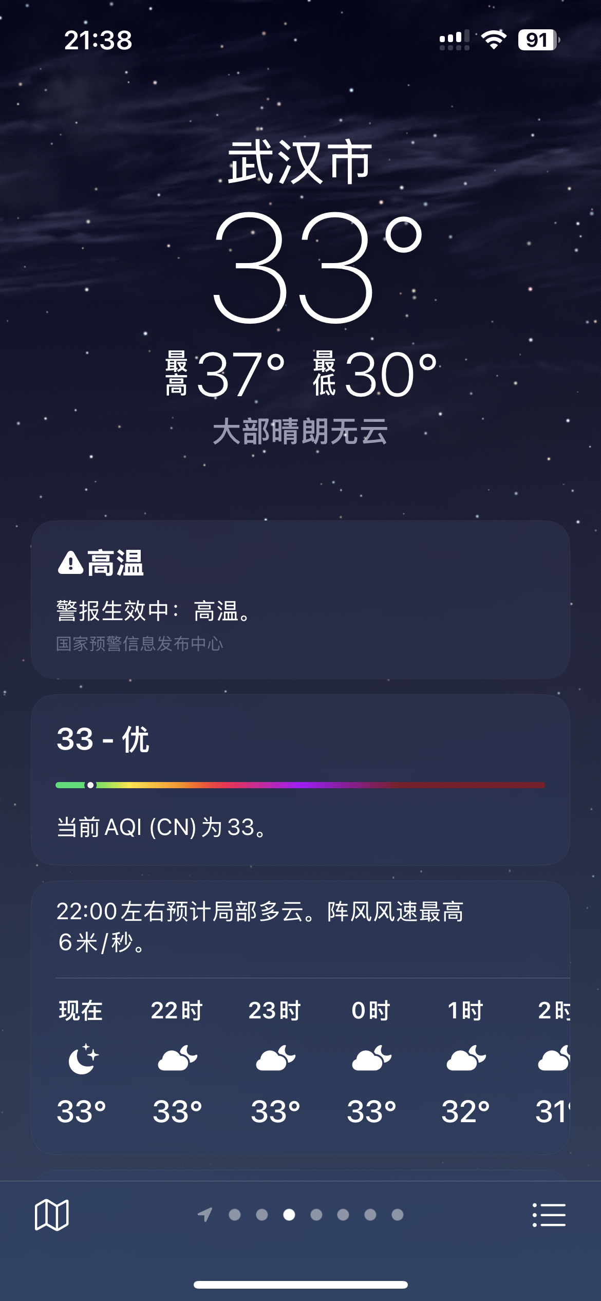

打开手机,进行比较
可以看到和手机上的天气预报一样准确
切换城市到 三亚
char TX_Data[]="GET https://api.seniverse.com/v3/weather/now.json?key=SfobYEEioM5L6dRce&location=sanya&language=zh-Hans&unit=c\r\n";
{"results":[{"location":{"id":"W7JZGDR3YYTF","name":"三亚","country":"CN","path":"三亚,三亚,海南,中国","timezone":"Asia/Shanghai","timezone_offset":"+08:00"},"now":{"text":"阴","code":"9","temperature":"26"},"last_update":"2025-07-25T21:30:19+08:00"}]}
CJSON解析后的数据
城市: 三亚 天气: 阴 气温: 26度 时间: 2025-07-25T21:30:19+08:00

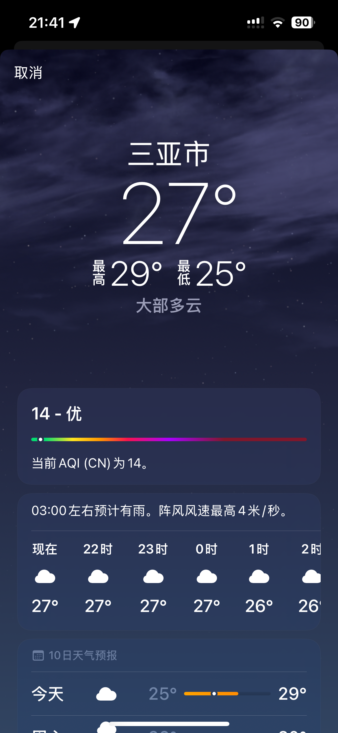

打开手机查看三亚天气预报
通过比较,天气预报非常的准确!!!!!!
