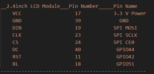

一、硬件连接
显示屏连接板卡的引脚

3.2、2.4inch_LCD_demo.py
Please make sure the 2.4inch LCD Moudle is connected to the correct pins.
The following table describes how to connect the 2.4inch LCD Module to the 40-pin header.
__2.4inch LCD Module___Pin Number_____Pin Name
VCC 17 3.3 V Power
GND 39 GND
DIN 19 SPI MOSI
CLK 23 SPI SCLK
CS 24 SPI CE0
DC 40 GPIO44
RST 11 GPIO42
BL 18 GPIO51

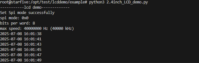

四、运行结果
4.1、运行程序
root@starfive:/opt/test/lcddemo/example
4.2、终端打印输出
