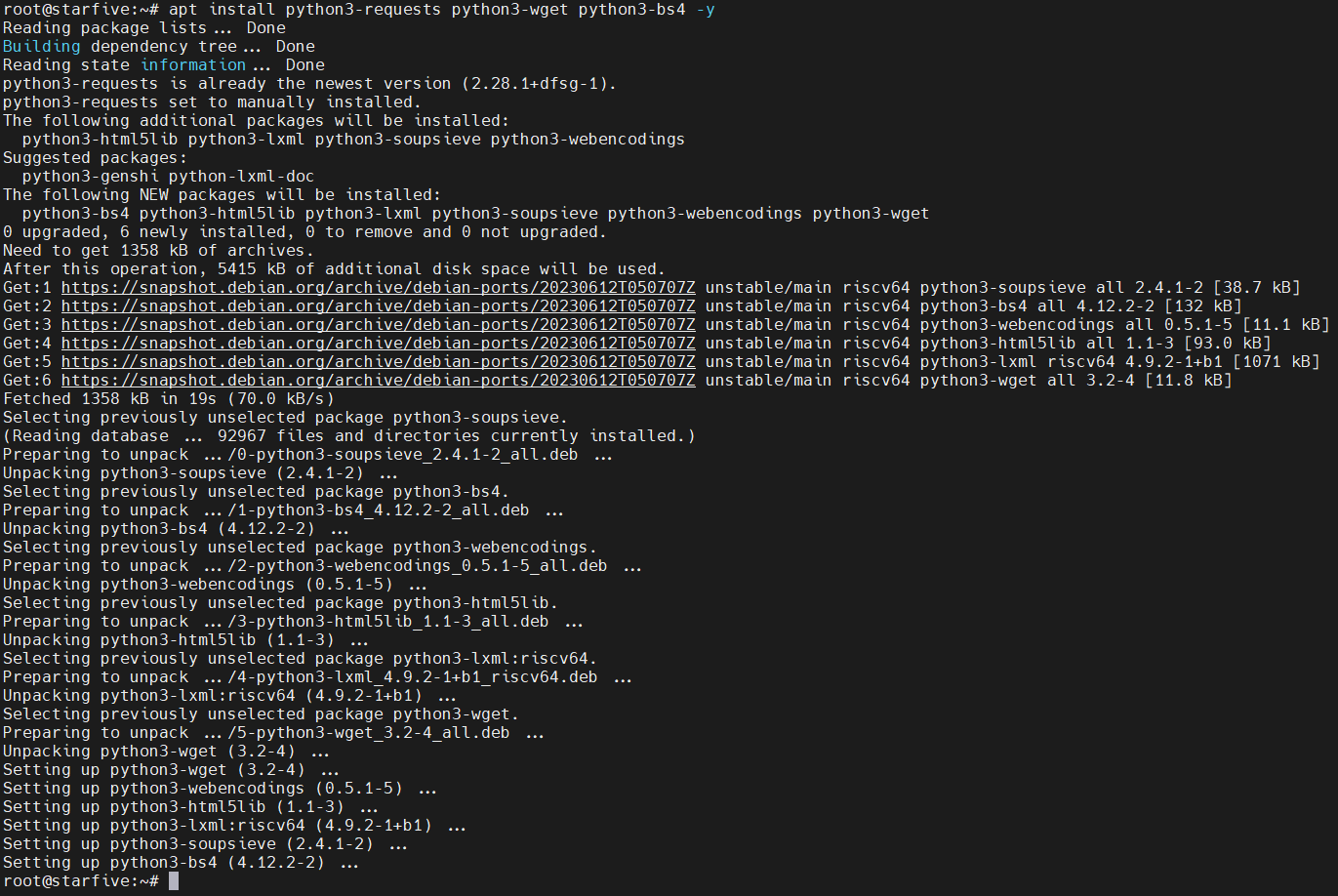

apt install libxml2-dev libxslt-dev
python3 -m pip install requests wget bs4
安装过程中遇到点问题
报错:error: externally-managed-environment
执行命令
apt install python3-requests python3-wget python3-bs4 -y
正常安装

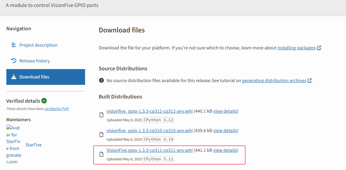

下载最新的VisionFive.gpio
下载地址:VisionFive.gpio
该版本有三个下载链接
根据系统安装的python版本来选择,选择系统版本对应的python 3.11

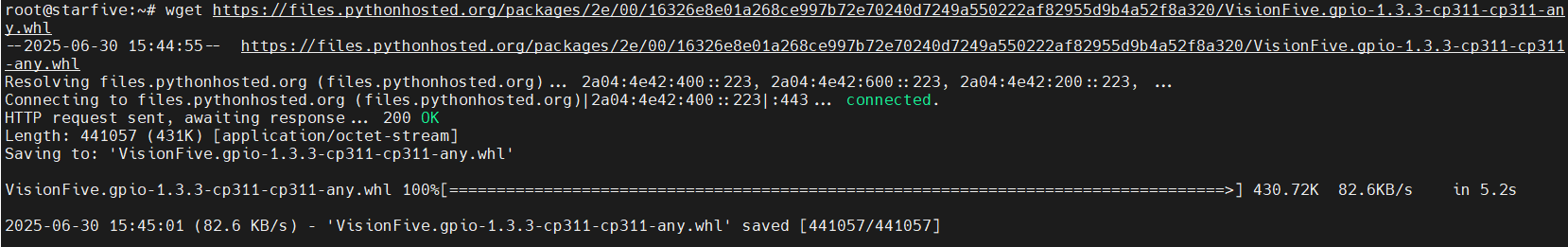

执行下载命令:
wget https://files.pythonhosted.org/packages/2e/00/16326e8e01a268ce997b72e70240d7249a550222af82955d9b4a52f8a320/VisionFive.gpio-1.3.3-cp311-cp311-any.whl
修改文件名:
mv VisionFive.gpio-1.3.3-cp311-cp311-any.whl VisionFive.gpio-1.3.3-cp311-cp311-linux_riscv64.whl
安装
python3 -m pip install VisionFive.gpio-1.3.3-cp311-cp311-linux_riscv64.whl --break-system-packages

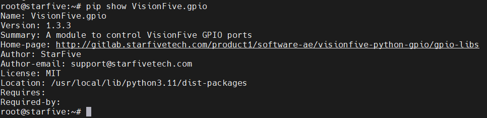

2.1、查看VisionFive.gpio安装的目录
pip show VisionFive.gpio
进入目录
cd /usr/local/lib/python3.11/dist-packages/

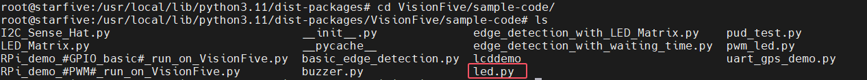

cd VisionFive/sample-code/
找到led.py

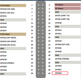

根据测试的硬件修改对应的端口
这里测试使用GPIO44端口,对用引脚号为40
修改led.py
Please make sure the LED is connected to the correct pins.
The following table describes how to connect the LED to the 40-pin header.
_______LED_________Pin Number_____Pin Name
Positive 22 GPIO50
Negative 6 GND
