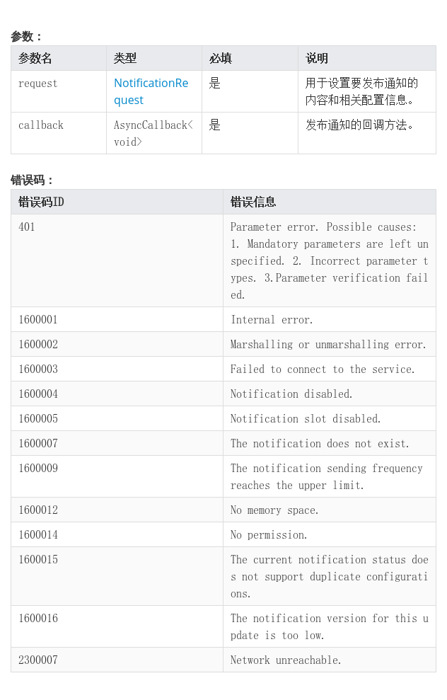

1.notificationManager.publish
支持设备Phone2in1TabletCarWearable
publish(request: NotificationRequest, callback: AsyncCallback): void
发布通知。使用callback异步回调。
如果新发布通知与已发布通知的ID相同,且label相同,则新通知将取代原有通知。
系统能力:SystemCapability.Notification.Notification
HarmonyOS NEXT应用开发-Notification Kit(用户通知服务)概述与notificationManager.publish-鸿蒙开发者社区
示例:
import { BusinessError } from '@kit.BasicServicesKit';
// publish回调
let publishCallback = (err: BusinessError): void => {
  if (err) {
    console.error(`Failed to publish notification. Code is ${err.code}, message is ${err.message}`);
  } else {
    console.info(`Succeeded in publishing notification.`);
// 通知Request对象
let notificationRequest: notificationManager.NotificationRequest = {
  content: {
    notificationContentType: notificationManager.ContentType.NOTIFICATION_CONTENT_BASIC_TEXT,
    normal: {
      title: "test_title",
      text: "test_text",
      additionalText: "test_additionalText"
notificationManager.publish(notificationRequest, publishCallback);

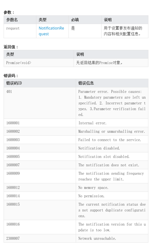

2.notificationManager.publish
publish(request: NotificationRequest): Promise
发布通知。使用Promise异步回调。
示例:
// 通知Request对象
  content: {
    normal: {
      text: "test_text",
notificationManager.publish(notificationRequest).then(() => {
}).catch((err: BusinessError) => {
本文主要参考引用自HarmonyOS官方网站
