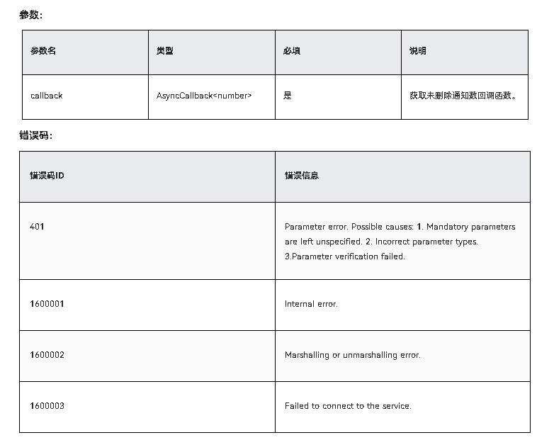

1.notificationManager.getActiveNotificationCount
支持设备Phone2in1TabletCarWearable
getActiveNotificationCount(callback: AsyncCallback): void
获取当前应用未删除的通知数。使用callback异步回调。
系统能力:SystemCapability.Notification.Notification
HarmonyOS NEXT应用开发-Notification Kit(用户通知服务)notificationManager.getActiveNotificationCoun-鸿蒙开发者社区
示例:
import { BusinessError } from '@kit.BasicServicesKit';
let getActiveNotificationCountCallback = (err: BusinessError, data: number): void => {
  if (err) {
    console.error(`Failed to get active notification count. Code is ${err.code}, message is ${err.message}`);
  } else {
    console.info(`Succeeded in getting active notification count, data is ` + JSON.stringify(data));
notificationManager.getActiveNotificationCount(getActiveNotificationCountCallback);

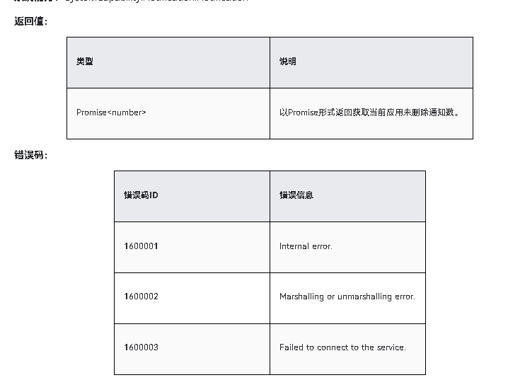

2.notificationManager.getActiveNotificationCount
getActiveNotificationCount(): Promise
获取当前应用未删除的通知数。使用Promise异步回调。
示例:
notificationManager.getActiveNotificationCount().then((data: number) => {
}).catch((err: BusinessError) => {
