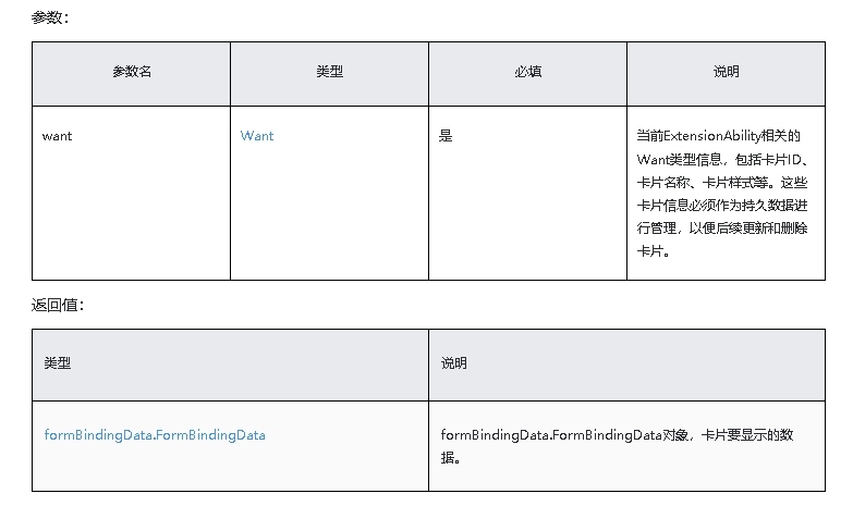

onAddForm(want: Want): formBindingData.FormBindingData
卡片提供方接收创建卡片的通知接口。
系统能力:SystemCapability.Ability.Form
鸿蒙原生应用/元服务开发-Stage模型能力接口(十)上-鸿蒙开发者社区
示例:
import FormExtensionAbility from '@ohos.app.form.FormExtensionAbility';
import formBindingData from'@ohos.app.form.formBindingData';
export default class MyFormExtensionAbility extends FormExtensionAbility {
  onAddForm(want) {
    console.log('FormExtensionAbility onAddForm, want:' + want.abilityName);
    let dataObj1 = {
      temperature:'11c',
      'time':'11:00'
    let obj1 = formBindingData.createFormBindingData(dataObj1);
    return obj1;

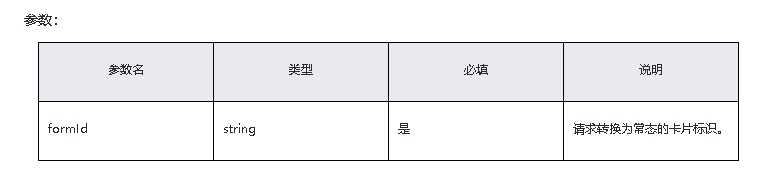

onCastToNormalForm(formId: string): void
卡片提供方接收临时卡片转常态卡片的通知接口。
示例
  onCastToNormalForm(formId) {
    console.log('FormExtensionAbility onCastToNormalForm, formId:' + formId);

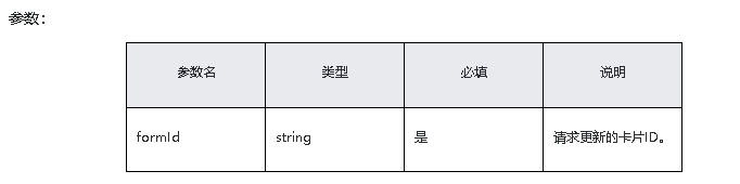

onUpdateForm(formId: string): void
卡片提供方接收更新卡片的通知接口。获取最新数据后调用formProvider的updateForm接口刷新卡片数据。
示例:
import formBindingData from '@ohos.app.form.formBindingData';
import formProvider from '@ohos.app.form.formProvider';
  onUpdateForm(formId) {
    console.log('FormExtensionAbility onUpdateForm, formId: ${formId}');
    let obj2 = formBindingData.createFormBindingData({
      temperature: '22c',
      time: '22:00'
    formProvider.updateForm(formId, obj2).then((data) => {
      console.log('FormExtensionAbility context updateForm, data: ${data}');
    }).catch((error) => {
      console.error('Operation updateForm failed. Cause: ${error}');
