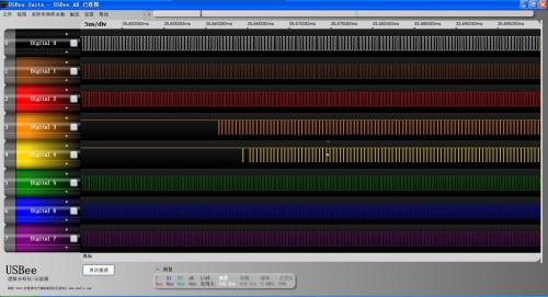

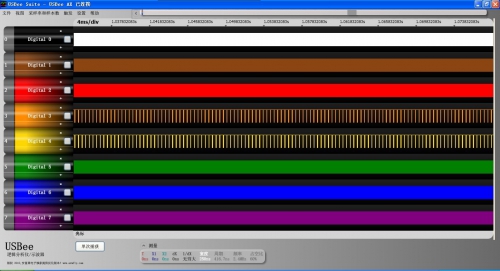

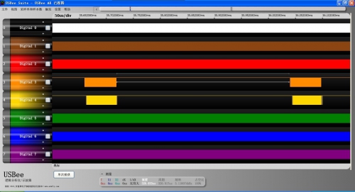

整个程序就是下面代码 用的是RMDK4.12 3.30固件库 #include "STM32f10x.h" GPIO_InitTypeDef GPIO_InitStructure; int main(void) { RCC_APB2PeriphClockCmd(RCC_APB2Periph_GPIOB, ENABLE); //使能GPIOB GPIO_InitStructure.GPIO_Pin = GPIO_Pin_All; //选择GPIOB全部IO口 GPIO_InitStructure.GPIO_Mode = GPIO_Mode_Out_PP; //推挽输出 GPIO_InitStructure.GPIO_Speed = GPIO_Speed_50MHz; //IO口最大输出频率 GPIO_Init(GPIOB,&GPIO_InitStructure); //按以上三条规则初始化GPIOB while (1) { GPIO_Write(GPIOB, 0x0000); //GPIOB 全部为低电平 GPIO_Write(GPIOB, 0xFFFF); //GPIOB 全部为高电平 } } PB3 PB4的IO口一直都是拉高 即使用命令拉低IO口还是会自动拉高 求指导...... |
