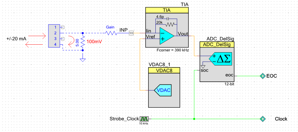

源4-20MA允许在电路中包含低电阻电阻器。鲍伯建议使用分流器。我喜欢下面的图像。当然,没有电隔离。
20M.PNG 33.8 K 以上来自于百度翻译 以下为原文 Sources 4-20 mA allow the inclusion of low-resistance resistor in the circuit. Bob suggested the use of a shunt. I do like the image below. Of course there is no galvanic isolation.

用TIA的解决方案不合适。这是因为您正在用外部设置G。
R,从而将TIA转换为V放大器。原因是芯片20K TIA R,最有可能, 一个可怕的绝对值,根据DS的60%。而是使用PGA,其中G是F(R/R), 与之对应的R片的片上精度相当好,参见PGA的G规格,最高G 5%。 g精度。 注A/D有一个G可编程输入缓冲器,1, 2, 4,8克的可用。如果需要更多的G 使用PGA。 问候,Dana。 以上来自于百度翻译 以下为原文 The solution with TIA not appropriate. This is because you are settting G with external R, thereby converting TIA to V amplifier. Reason is the onchip 20K TIA R has, most likely, a horrible absolute value, 60% according to DS. Rather use a PGA, where G is a f( R/R ), and onchip accuracies of ratioed R's is quite good, see G spec for PGA, at highest G 5% G accuracy. Note A/D has a G programmable input buffer, 1, 2 , 4 , 8 G's are available. If more G needed use PGA. Regards, Dana. |
