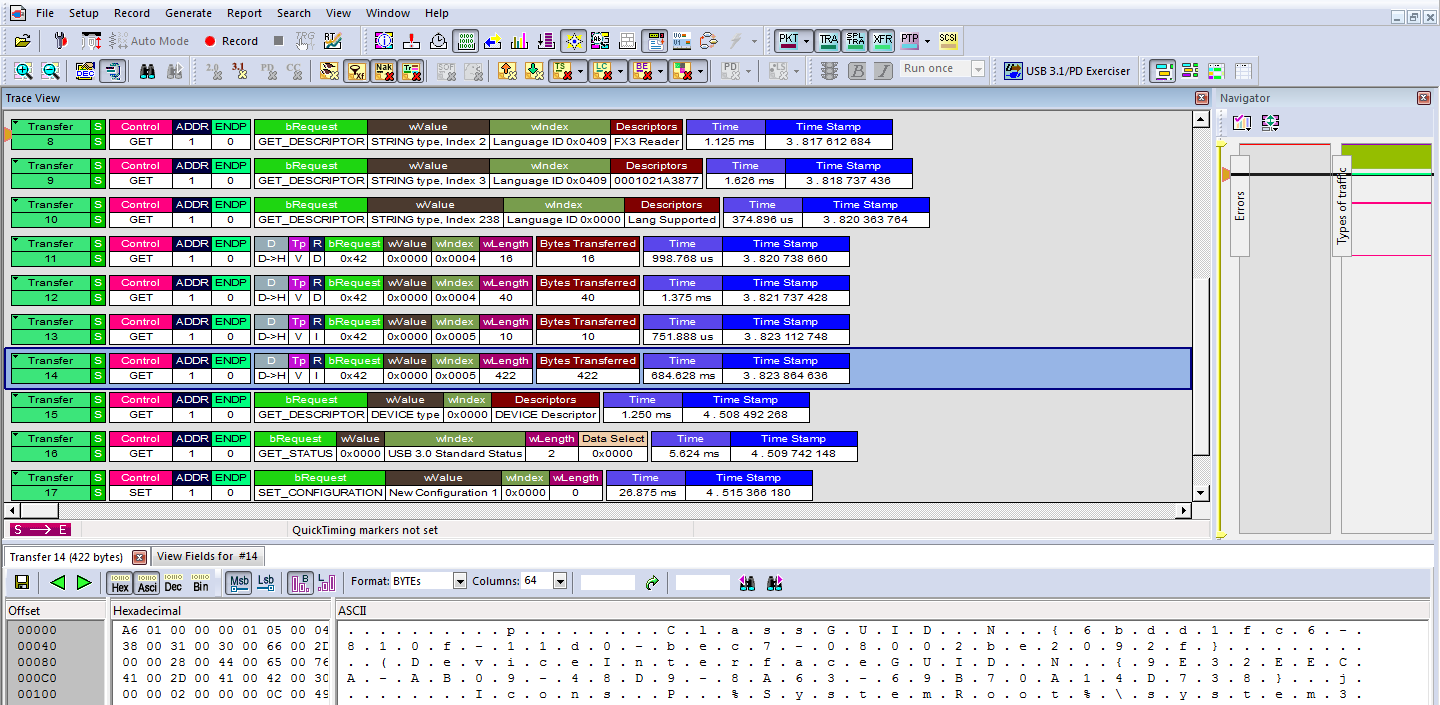

HI Sbrtand,当我正在处理我们的问题时,我读到一些控制器驱动程序使用不正确的请求来获得描述符:例如错误的ByType、BTAbor、BReQuest.如果你有一个USB分析器,你可以找出控制器的描述符请求的细节。有了这方面的知识,你可以在FX3中修改你的描述符处理,所以它用期望的描述符来响应这个(不正确的)请求,补偿控制器错误。 以上来自于百度翻译 以下为原文 Hi ***ertrand, Back when I was working on our issue, I read that some controller drivers use incorrect requests to get descriptors: e.g. wrong bType, bTarget, bRequest. If you have an USB analyzer, you can find out the details of your controller's descriptor requests. With this knowledge you can adapt your descriptor handling in the FX3, so it responds to this (incorrect) request with the expected descriptor, compensating for the controller bug? |
嗨,丹尼尔,
我看了我的分析仪记录,但没有任何要求。对于Ext PROP的请求与最近的驱动程序没有发生。 通过分析器,我补偿了EXT PROP作为设备请求而不是接口请求发生的请求。 最近的司机不太合适。我的卡固件可能是旧的或不匹配驱动程序。 以上来自于百度翻译 以下为原文 Hi Daniel, I looked at my analyzer recording but there is no request at all. The request for the Ext Prop are not happening with the recent driver. With the analyzer, I did compensate for the request of the Ext Prop happening as a Device Request instead of a Interface Request. The recent drivers are just not suitable. My card firmware may be old or not matching the driver. |
我面临一个关于MSFT扩展属性OS描述符和ReSAS XHCI主机控制器的新问题。可以正确地报告Unicode字符串EXT PROP。我为暂停空闲配置定义了DWORDExt Prop(Debug、Debug、TimeLeTimeOutlook、DeVice)。
在英特尔USB主机控制器(EHCI和XHCI)上,注册表值是正确的,并且暂停/恢复测试正确地发生。然而,当设备被ReSAS XHCIHOST控制器完全枚举时,DWord Ext PROP将作为Unicode字符串报告给系统。我的500毫秒OfDebug的超时值显示为“Debug”。“十进制F4 01或500”。 瑞萨电子USB 3主机控制器驱动程序版本2.0.34.0。 以上来自于百度翻译 以下为原文 I am facing a new issue regarding MSFT Extended Property OS Feature Descriptor and Renesas XHCI Host controller. Unicode String Ext Prop are able to be reported correctly. I am defining DWORD Ext Prop for suspend idle configuration (DefaultIdleState, DefaultIdleTimeout, DeviceIdleEnabled, DeviceIdleIgnoreWakeEnable). On Intel USB Host controllers ( EHCI and XHCI ), the registry values are correct and suspend/resume testing occurs correctly. However when the device is fully enumerated by the Renesas XHCI Host controller, the DWORD Ext Prop are reported to the system as unicode strings. My value of 500 ms of DefaultIdleTimeout shows up as "DefaultIdleTimeout"="Ǵ". "Ǵ" is 00 F4 01 or 500 in decimal. Renesas Electronics USB 3.0 Host Controller Driver version 2.0.34.0. |
