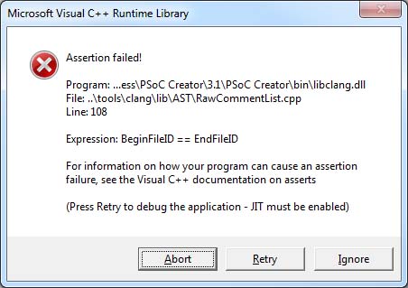

然而,我发现从PSoC Creator 2.2升级到3.1最近合理。我想是星期五,也许是星期四。我立刻遇到了一个重现性的崩溃。那么今天,我得到一个蓝屏死机和损坏的项目文件,将不再打开。它暂时失去了我的顶级设计和代码编辑。幸运的是,我有每小时自动备份。我能恢复的项目,包括最新的顶层设计的变化(超过一小时),然后复制我的独立的C文件到回收项目,我最近的代码编辑。我只是失去了约2小时,包括启动和其他东西加载状态。 所以我必须找到这个问题的底部,或者回到2.2。 重复出现死机的情况几乎任何**的时候我试图在源代码编辑#宏。这个软件尝试做实时预编译和语法检查,无论你怎么称呼。我相信这是一个问题。如果我试图在#类型包括“文件名。H”,然后出现大跌,100的每一次当我键入“E”完成了“#包括“。我已经附加了错误信息的JPG。而我能型”#如果0“我经常做暂时删除一段代码,我后来当我键入“# endif”得到同样的崩溃,对整理后的单词以字母“F”。 我不知道我在做什么死亡蓝色屏幕时发生。我想,如果再发生这种事,我会担心的。 非常感谢您的帮助。 -赫尔穆特 错误MSG JPG 50.6 K 以上来自于百度翻译 以下为原文 Well, me? I like to stick with the version of software that I know works, and I always try to disable automatic updates. Nevertheless, I found it reasonable recently to upgrade from PSoC Creator 2.2 to 3.1. I think it was Friday; maybe Thursday. I was immediately met with a reproducible crash. Then today, I got a blue screen of death and a corrupted project file that would no longer open. It temporarily lost my top design and code edits. Fortunately, I have *hourly* automatic backups. I was able to restore the project, including most recent top design changes (more than an hour old), then copy my free-standing c file back into the project, recovering my recent code edits. I only lost about 2 hours, including the reboot and reload of other status stuff. So I must get to the bottom of this problem, or go back to 2.2. The reproducible crash situation occurs pretty much *any* time I try to edit a #macro in the source code. This software tries to do real-time advance compiling and syntax checking, whatever you call that. And I believe it is a problem with this and #macros. If I try to type in #include "filename.h", then the crash occurs 100% every time when I type the "e" finishing up "#include". I've attached a jpg of the error message. While I can type "#if 0" as I often do to temporarily remove a chunk of code, I get the same crash when I later type "#endif", right after finishing the word with the letter "f". I don't know exactly what I was doing when the blue screen of death occurred. I'll worry about that, I guess, if it happens again. Your assistance with this is greatly appreciated. -Helmut

柏发现问题,这似乎是一个普遍错误3.1。我试过下面推荐的修复方法,效果不错。
塞浦路斯写道: 你好,赫尔穆特,很抱歉给您带来不便。为了解决这个问题,只要输入新的线端主。C文件如下:323 / * [ ]文件结束*/324这里,324是主要的最后一行数。C文件。我们感谢你对我们的PSoC Creator这将极大的有助于提高指向误差PSoC Creator的未来版本。谢谢和问候,Piyush 以上来自于百度翻译 以下为原文 Cypress found the problem, and it seems to be a general bug in 3.1. I tried the recommended fix below, and it WORKED. Cypress wrote: Hello Helmut, We are sorry for your inconvenience. To solve this issue, just enter new line at end of your main.c file as follow: 323 /* [] END OF FILE */ 324 Here, 324 is the last line number of main.c file. We are thankful to you for pointing error in our PSoC Creator which will great helpful to improve future version of PSoC Creator. Thanks and Regards, Piyush |
赫尔穆特,谢谢你通知我们!我可以复制这个问题(我只得到一个断言),它在文件结尾的换行符中消失了。好讨厌的虫子!
如果你有同样的错误,在某些新行之上 鲍勃 以上来自于百度翻译 以下为原文 Helmut, thank you for keeping us informed! I could reproduce the issue (I get an assertion only) and it goes away with the newline at end of file. Great nasty bug! Above some newlines if you have got the same error Bob |
