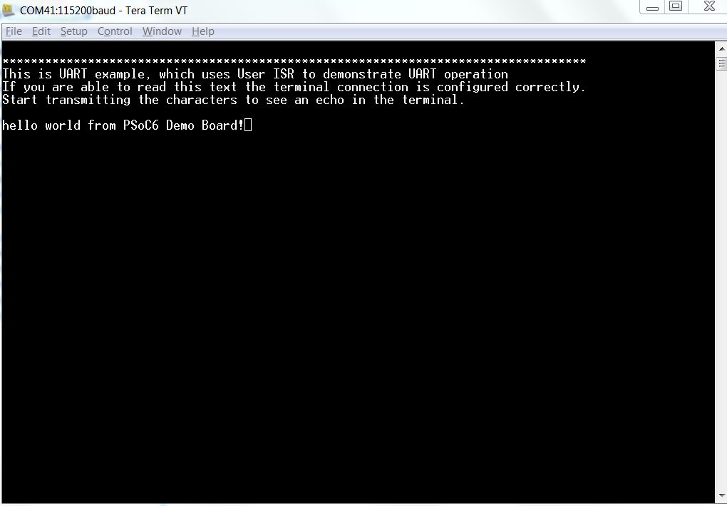

Would you please help for this case? I can upload my test project if necessary. Thank you! Best regards, Lei #include "project.h" uint8_t UartRxFlag = 0; uint8_t UartRxDat = 0; uint32_t SysTickCnt = 0; void ISR_UART(void) { /* Check for "RX fifo not empty interrupt" */ if((UART_HW->INTR_RX_MASKED & SCB_INTR_RX_MASKED_NOT_EMPTY_Msk ) != 0) { /* Clear UART "RX fifo not empty interrupt" */ UART_HW->INTR_RX = UART_HW->INTR_RX & SCB_INTR_RX_NOT_EMPTY_Msk; UartRxDat = Cy_SCB_UART_Get(UART_HW); UartRxFlag = 1; } } void SysTickIsrHandler(void) { SysTickCnt ++; } int main(void) { uint16_t i = 0; Cy_SysTick_Init(CY_SYSTICK_CLOCK_SOURCE_CLK_IMO,7999); for (i = 0u; i < CY_SYS_SYST_NUM_OF_CALLBACKS; ++i) { if (Cy_SysTick_GetCallback(i) == NULL) { Cy_SysTick_SetCallback(i, SysTickIsrHandler); break; } } cy_en_scb_uart_status_t init_status; /* Start UART operation. */ init_status = Cy_SCB_UART_Init(UART_HW, &UART_config, &UART_context); if(init_status!=CY_SCB_UART_SUCCESS) { } Cy_SCB_UART_Enable(UART_HW); /* Transmit header to the terminal. */ Cy_SCB_UART_PutString(UART_HW, "rn**********************************************************************************rn"); Cy_SCB_UART_PutString(UART_HW, "This is UART example, which uses User ISR to demonstrate UART operationrn"); Cy_SCB_UART_PutString(UART_HW, "If you are able to read this text the terminal connection is configured correctly.rn"); Cy_SCB_UART_PutString(UART_HW, "Start transmitting the characters to see an echo in the terminal.rn"); Cy_SCB_UART_PutString(UART_HW, "rn"); /* Unmasking only the RX fifo not empty interrupt bit */ UART_HW->INTR_RX_MASK = SCB_INTR_RX_MASK_NOT_EMPTY_Msk; /* Interrupt Settings for UART */ Cy_SysInt_Init(&UART_SCB_IRQ_cfg, ISR_UART); /* Enable the interrupt */ NVIC_EnableIRQ(UART_SCB_IRQ_cfg.intrSrc); __enable_irq(); /* Enable global interrupts. */ /* Place your initialization/startup code here (e.g. MyInst_Start()) */ for(;;) { /* Place your application code here. */ if(UartRxFlag == 1) { UartRxFlag = 0; Cy_SCB_UART_Put(UART_HW,UartRxDat); } if(SysTickCnt >= 500) { SysTickCnt = 0; Cy_GPIO_Inv(LED_Green_P1_1_PORT,LED_Green_P1_1_NUM); } } } |

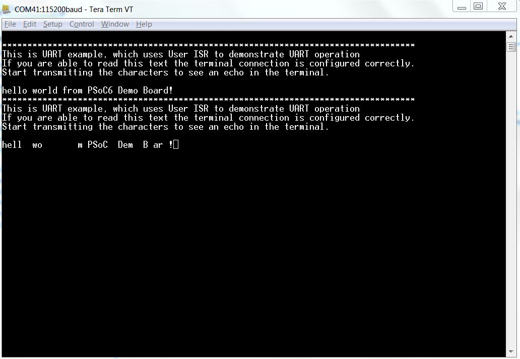

ncmza 发表于 2018-11-22 16:28 你好,鲍伯, 谢谢你的回复。 我有完整的项目和测试结果(屏幕截图): PSOC 6 BLE先锋套件测试。 1.UARTHI ISR.Cyrj.SovivyWork.Zip演示项目,SyBube 1ms中断,具有500毫秒LED闪烁。带有中断和回送的UART RX。所有功能运行在CORTEX-M4上。 复位/接通电源后,从PSoC6中键入“Hello World”! PSOC6EVB.CyWrk.CaseViWorkWork.JPG显示了测试结果。 2.UARTHI ISR.Cyrj.Access,Zip演示项目。在CordX-M4上CordX-M0+,Uart的Sytle。 复位/接通电源后,从PSoC6中键入“Hello World”! PSOC6EVB.CyWrk.Access Vo.JPG显示测试结果。似乎有一些字节丢失/错误RX/TX。 请让我知道如果需要任何进一步的信息。 谢谢。 最好的问候, 雷 PSOC6EVB.CyWrk.Access 91.3 K UpTr.Ir.Cyrj.Access 6.4兆字节 PSOC6EVB.CyWrk.CaseViWorkWork.JPG 60.4 K Urthu.ISr.Cyrj.ActuviWork.Zip 6.4兆字节 以上来自于百度翻译 以下为原文 Hello Bob, Thanks for your reply. I have the complete projects and test result(screen shot picture) : Tested on PSoC 6 BLE Pioneer Kit. 1.UART_ISR.cyprj.Archive_Works Well.zip Demo project, Systick 1ms Interrupt, with 500MS LED blink. Uart RX with interrupt and send back. All function run on Cortex-M4. After reset/power on, type"hello world from PSoC6!" PSoC6EVB.cywrk.Archive_Works Well.JPG shows the test result. 2.UART_ISR.cyprj.Archive_Problem.zip Demo project. Systick on Cortex-M0+, Uart on Cortex-M4. After reset/power on, type"hello world from PSoC6!" PSoC6EVB.cywrk.Archive_Problem.JPG shows the test result. Seems some Byte was lost / wrong Rx/Tx. Please kindly let me know if need any further information. Thanks. Best regards, Lei
你好, 我在CY8CKIT-062-BLE上测试了你们的两个代码,工作得很好,除了我必须改变UART的PIN配置为TX= P9[ 1 ]和RX= P9〔0〕。当引脚被设置为TX= P5(1)和RX= P5(0),只有UART传输工作,接收不工作,我验证PIN P5(0)的我的工具包,发现它工作时,配置为输入,所以没有问题的PIN被配置为输入,但不知道为什么它不作为RX工作。我知道这听起来很愚蠢,但您可以配置PIX为Tx= P9(1)和RX= P9(0),并看到结果。也没有这样的信息“你好世界从PSoC6演示板!”在你的两个项目中。 以上来自于百度翻译 以下为原文 Hello, I tested your both code on CY8CKIT-062-BLE and worked perfectly fine except that I had to change pin configuration for UART as Tx=P9[1] and Rx=P9[0]. When pins were set as Tx=P5[1] and Rx=P5[0] only UART transmission was working and reception was not working, I verified pin P5[0] of my kit and found it working when configured as input so no problem with pin when configured as input but don't know why it isn't working as RX. I know this sounds foolish but you can configure pins as Tx=P9[1] and Rx=P9[0] and see the result. Also there is no such message "hello world from PSoC6 Demo Board!" in your both projects. |
diaoshayu 发表于 2018-11-22 16:50 你好, 谢谢你的回复。 来自PSoC6演示板的“Hello World”!是我在终端上输入的。因此,如果UART工作正常,字符将回传我的UART。 我使用P5〔0〕和P5〔1〕,因为它们与车载KETPUG连接,所以我可以使用USB进行UART调试。 但是P5〔0〕和P5〔1〕可用作无CalTX-M0+的Syle功能的UART引脚。我不知道这是双核问题还是别的什么。 我会尝试修改UART到P9,然后再试一次。 谢谢您! 最好的问候, 雷 以上来自于百度翻译 以下为原文 Hello, Thanks for your reply. The "hello world from PSoC6 Demo Board!" is what i typed in the terminal. So if the uart works well, the character will loop back my UART. I using P5[0] and P5[1] because they are connected with the on board kitporg so I can use USB for UART debug. But the P5[0] and P5[1] can be used as UART pins without Systick funciton on cortex-M0+. I don't know if this is dual-core issue or something. I will try to modify UART to P9 and try again. Thank you! Best regards, Lei |
aslkmdsa 发表于 2018-11-22 17:04 你好,雷, 请您尝试从这个线程的创建者最新的beta版:PSoC Creator 4.2 beta 2公告!? 我已经在以后的版本中测试了你的项目,它们看起来很好,两个项目都很好。 所以,让我们知道,如果你仍然面临的问题与最新的建设。 当做, Meenakshi Sundaram R 以上来自于百度翻译 以下为原文 Hello Lei, Can you please try the latest beta release of creator from this thread: PSoC Creator 4.2 Beta 2 Announcement! ? I had tested your projects in the later builds and they seem to work fine - both the projects. So try and let us know if you still face the issue with the latest build. Regards, Meenakshi Sundaram R |
斯图尔特233 发表于 2018-11-22 17:22 你好,Meenakshi, 在使用最新PSoC Creator时,不能复制此问题。 谢谢你的帮助。 最好的问候, 雷 以上来自于百度翻译 以下为原文 Hello Meenakshi, This issue cannot be reproduced when using the latest PSoC Creator. Thanks for your kindly help. Best regards, Lei |
